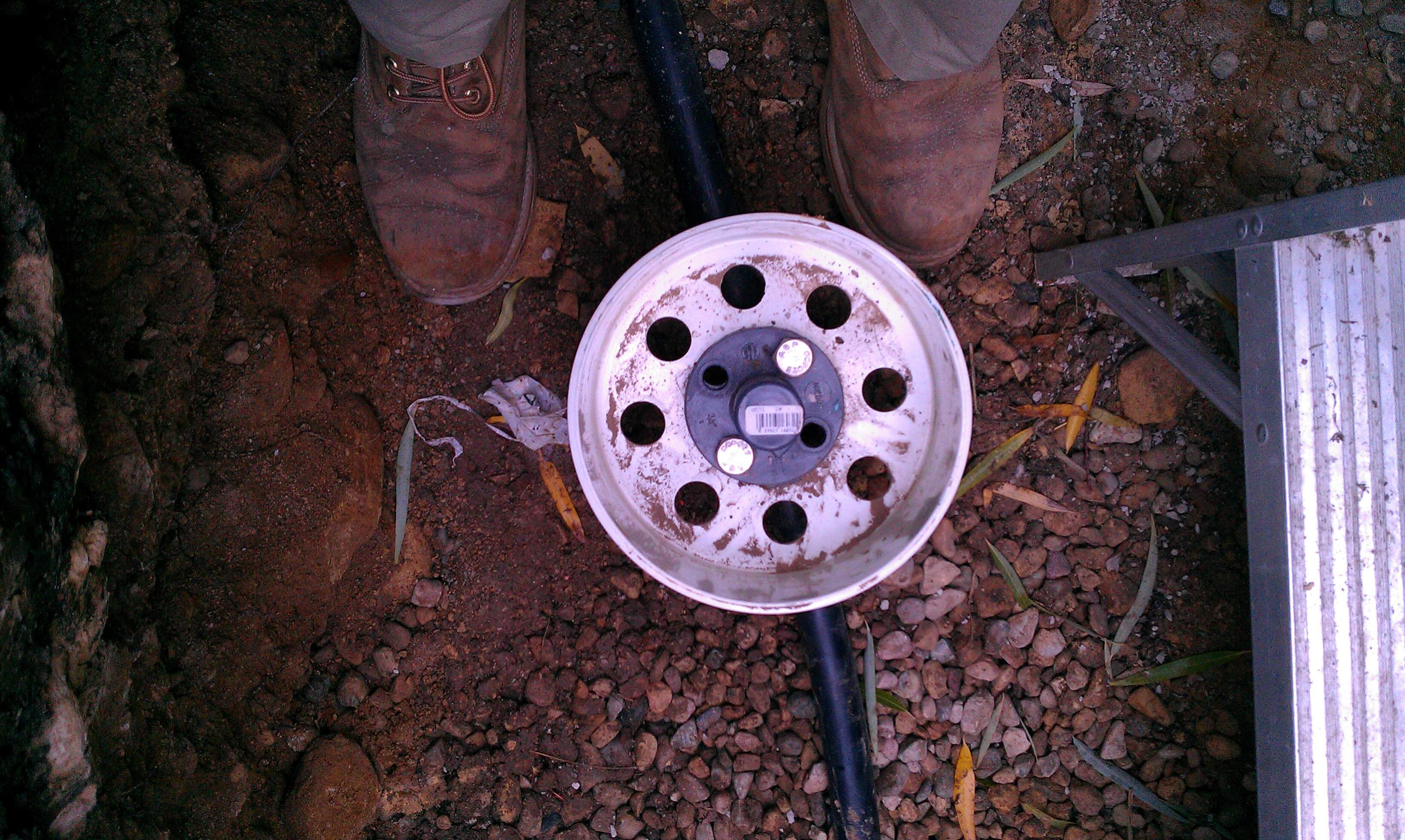

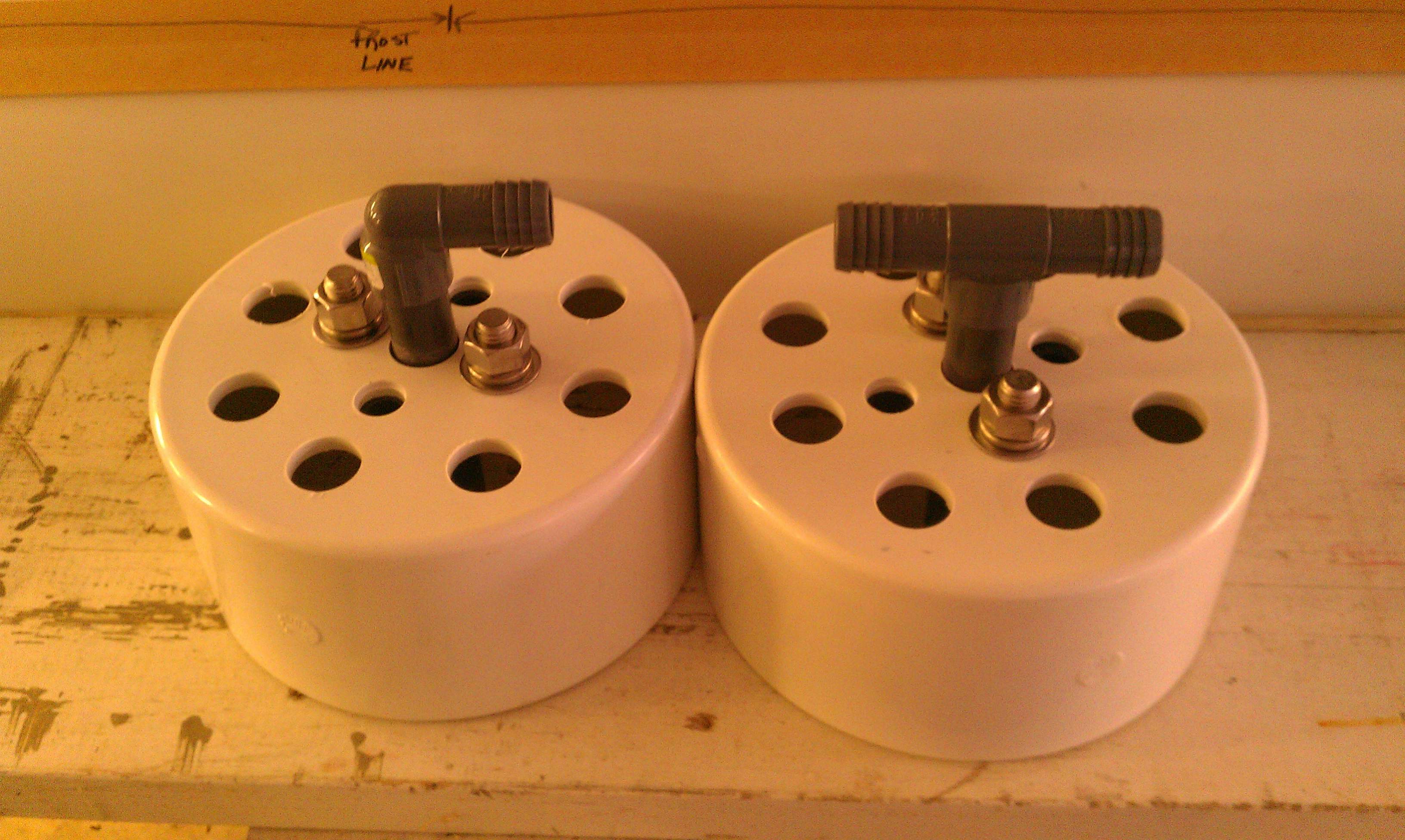

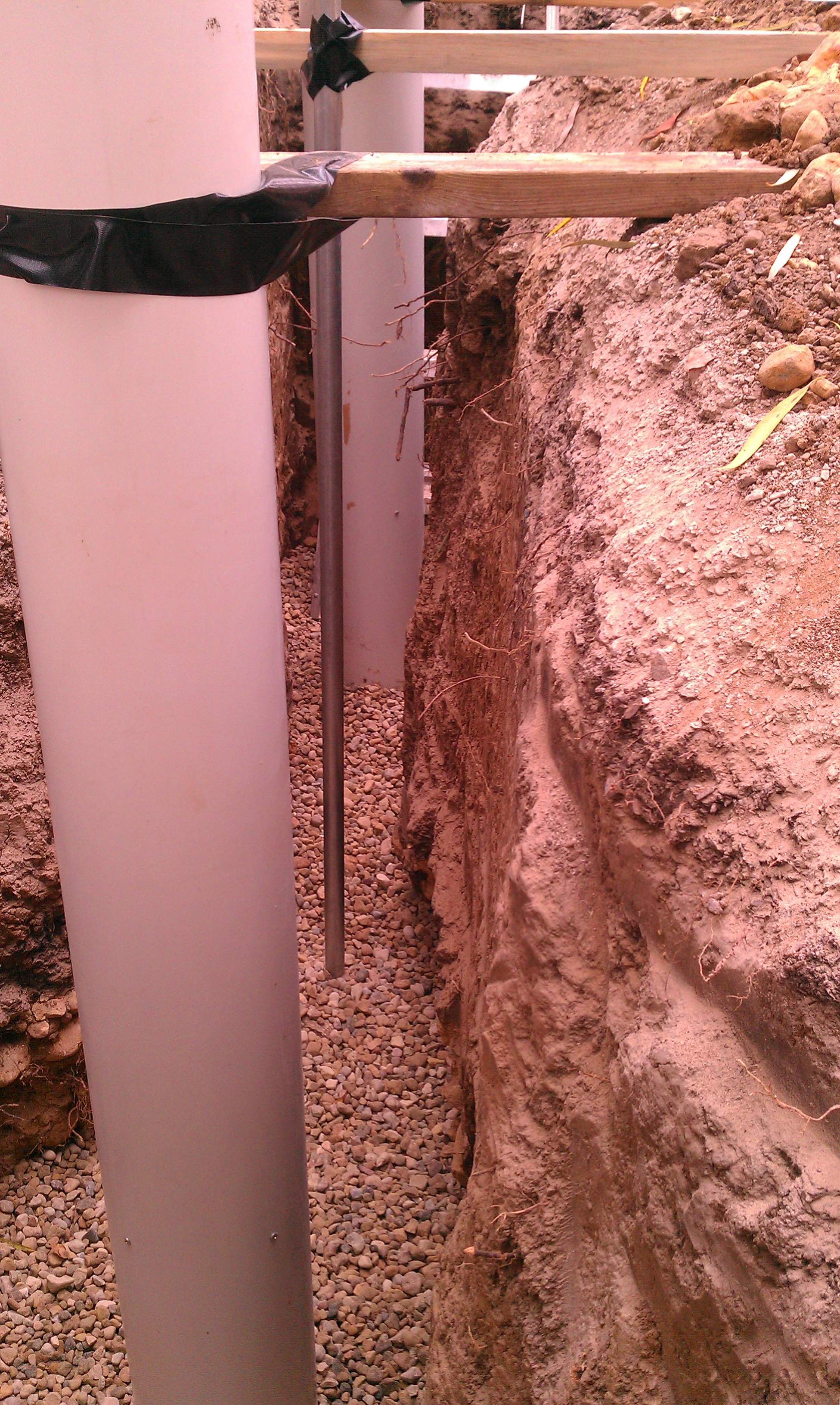

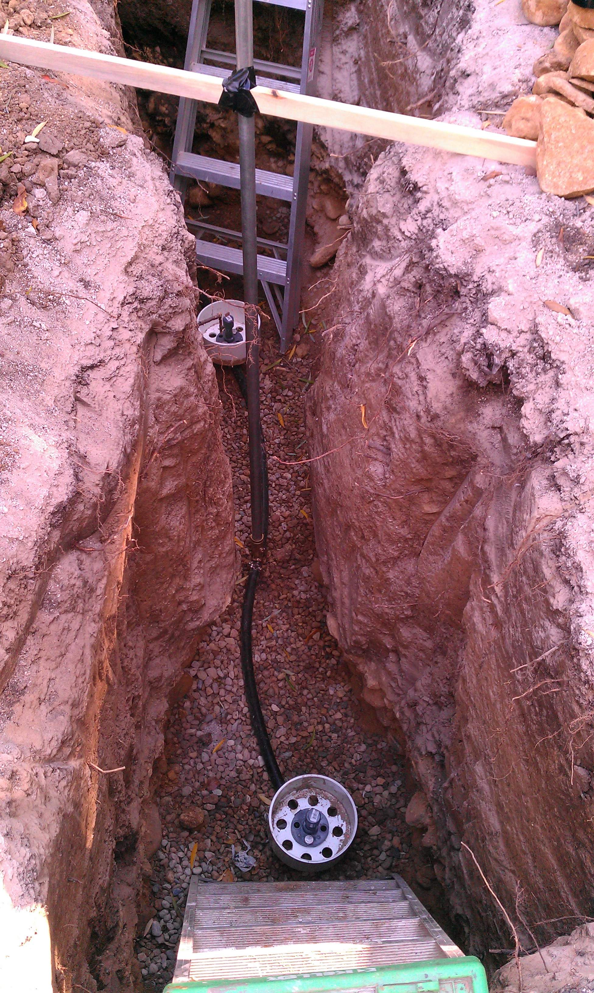

The external part of the unit is ~1/4" wall PVC, the internal components look well made, metal parts are stainless, everything else is some kind of plastic or PVC (photos 2,3). Excavation is a lot of work, the bottom of the unit has to be approximately 2' below the frost line, and it sits on a 10" deep gravel bed that acts as the dry well for the water that drains back. Our frostline is 42" so the bottom of the unit is located at about 66", and the trench was about 76" deep. I used #6 washed rock on the bottom for the drain. Instructions call for covering the rock with tar paper. I found that hard to work with and used a couple layers of geotex landscape fabric instead since I had it laying around (photo 8). My water supply was a 1" PE plastic line (photo 4), I used barbed fittings to adapt to the 3/4" plastic pipe fitting on the bottom of the unit (photo 3). I learned one thing about plastic insertion fittings: you're supposed to use 2 hose clamps oriented 180deg from each other for each connection. I turned on the water and let it sit overnight before assembly to test for leaks. There is a heavy plastic receiver dish in the bottom of the trench that connects to the water source, the 8' long drinking mechanism threads onto a fitting in that dish (photos 5,6). Since it's plastic threads, if you ever have to take it apart you can remove it from above ground, do any repairs, and then thread it back on. I used Oatey plastic thread seal on all the plastic parts. It's non-hardening and non-lubricating, and safe for plastic. Another thing I learned is not to use teflon products on plastic, they lead to overstressing the material because it's too easy to turn. Since I was doing all this I also installed a frostproof yard hydrant. Next step was backfilling (photo 7). Our soil is mostly rock and sand, you can see some of the really large rocks in the photos. I used the big rocks around our firepit (photo 10), only put the smaller stuff back in the hole. End up with about 30" of the post exposed above ground (photo 9). I made one mistake in not having limestone screenings on hand to put on top of the backfill because we had several days of rain right after the install, so the horses couldn't get near the drinkers or they'd sink in the mud. Once I got that fixed the training began. Neither horse had any trouble pushing down on the flap to activate the water flow, but one of our horses is really spooky and the sound of the water displacing the air as it comes up the tube scared her, so she jumped back and didn't hang around to drink. She's also kind of mouthy and bites on the plastic paddle. My wife does clicker training with our critters, so she's working with the horse to get her adjusted to the sound. I talked to the company and they have a few different style paddles, one for training and one for horses that chew. They're going to send me one of those to see if it helps. Overall my experience so far is positive. I'll post again after the freezing weather takes hold, I look forward to not paying for electricity. My wife likes these because the horses get clean water each time, it's always the same temp, and she doesn't have to clean out the troughs.

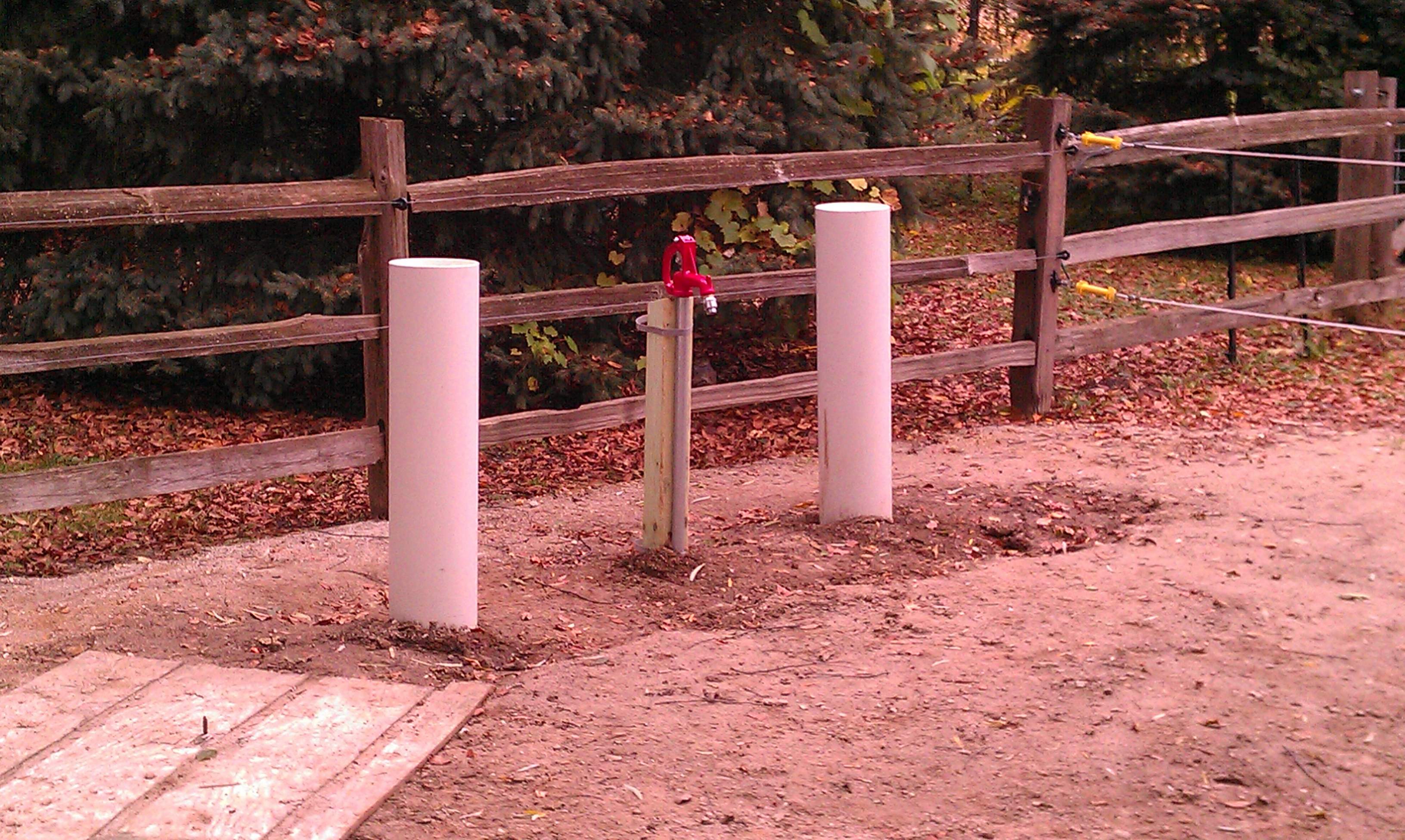

They make different lengths for different frostlines, you could get a shorter unit so the amount that sticks up above ground is about the same. I'm going to build a new barn next year and these two units will end up being inside rather than outside, that's why they're sort of out in the middle of nowhere right now. The grade will also go up about 12" so they won't be so high. I wanted to try two of these to see how they work through the winter before I install any more of them. Final plan is to install them in the horses stall, we want to board more horses. I was most interested in seeing how they perform in freezing rain, and the freeze/thaw snow cycle we get here. Even if the unit doesn't freeze up below ground, if the top's frozen the horse can't drink out of it. I figure worst case is I pour a bucket of hot water on it to thaw things, but that's a lot easier than dragging hoses around all winter.
