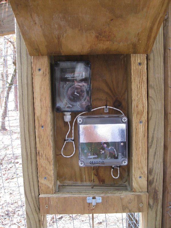

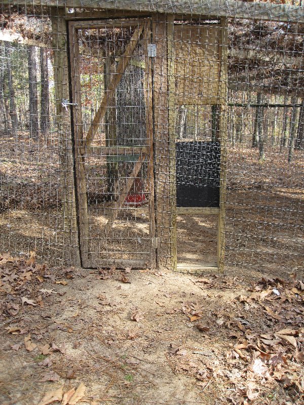

I recently installed an automatic door opener on my chicken pen. I let my chickens free range during the day, but I can't always make it home in the evenings before dark to lock the door (Or ever with the time change). The unit has a light sensor and I bought the external timer as well.
I ordered it from Automatic doors for poultry housing | VSB | VSB b | VSB bi | VSB b SA which is in England. It only took 11 calendar days to show up.
The bad: It is expensive! It was shipped all the way from England in a thinly padded plastic bag. My order did not contain the external light sensor, the batteries, the wires necessary to connect the opening unit with the timer and only 1 of the 4 replacement strings, all of which they claim must have fallen out in transit (back to the plastic bag issue).
The good: Very responsive to my e-mails. They wanted to ship me the missing parts, but gave me a refund for the missing parts instead, at my request. Easy to install and to program the timer.

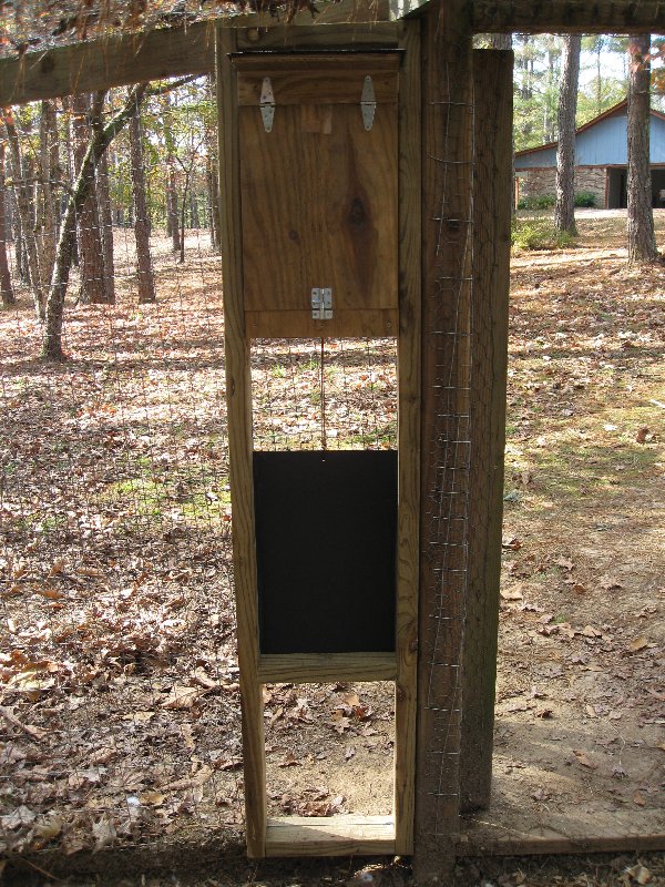

I built the door frame and used a thin piece of steel for the door. I put the controller and timer in a box to protect them even more from the elements. I am only using the timer, so I don't need the light sensor.
After a week of using it, I think it is fantastic! I really like not having to worry about letting them out in the mornings and being home to lock them up in the evenings. Can't wait until the next time I need to leave town...no more bothering the neighbors! :)
Here are some pictures: 1. outside, 2. inside, 3. the VSBb unit and timer.

I just purchased treated lumber for the frame and slotted it with a tablesaw. The door is a thin piece of 12x18" steel that I bought from Lowes for about $7.
View attachment 145811View attachment 145812View attachment 145813
The adjusting of the timer will become a nuisance very soon. Why don't u use an astronomical timer? They are not very expensive anymore.
