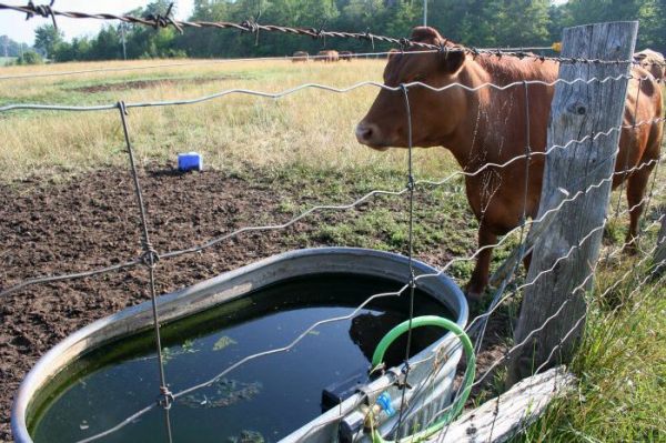

I have been using this cheap float valve for over 10 years with no problems. I use if from April to December for 20-25 heffers and 1 bull.

That's real similar to the cheap plastic on that is in my round pen right now.

Yep, that's pretty much what we use. If you have a fence to put it up against, that helps protect them. However, my troughs are out in the open.
I like dubba's idea, but I'm thinking on trying to modify it to my situation. I'll install a vertical piece of 6" diameter PVC pipe next to the trough and install a pipe between the two using the threaded drain plug on the water trough. I'll cap the 6" PVC to keep the cows from messing with it and install a float valve in it and connect the water pipe to it just below the ground. Since the two will be piped together, the water level will stay the same in each. This way, the float is enclosed and the cows can't mess with it. I can also insulate it to help protect against freezing weather which is mild here in central Texas.
Now, I just need to find a good way to connect the small diameter water pipe and tank pipe to such a large diamer PVC.
What do you guys think?
