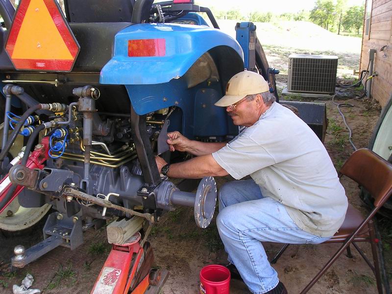

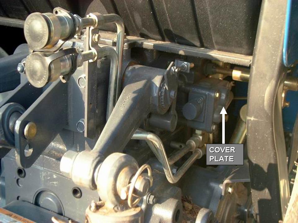

Here are some photos. The kits come with the levers, piping, and supports for the rear of the tractor. In the first picture, you can see the closeup of the first valve. For the remaining valves, you just remove the 4 bolts holding on the outer cover plate and stack on another valve up to 3. Each successive kit comes with the longer bolts needed to go through all the other valves. If you put three valves on at once, you end up with 8 bolts you don't need from the first two kits. The kits also come with o-ring seals. The only thing you need to have extra is teflon tape or liquid sealer for the piping joints. You want to make sure all joints are tight and leak free because it's a pain to get in to tighten them after you have them all stacked up.
In the second picture, you can see that with the right-rear wheel removed, I can sit in my folding chair to do the job. Any job this easy is something I think anyone with minimum skills like me can do.

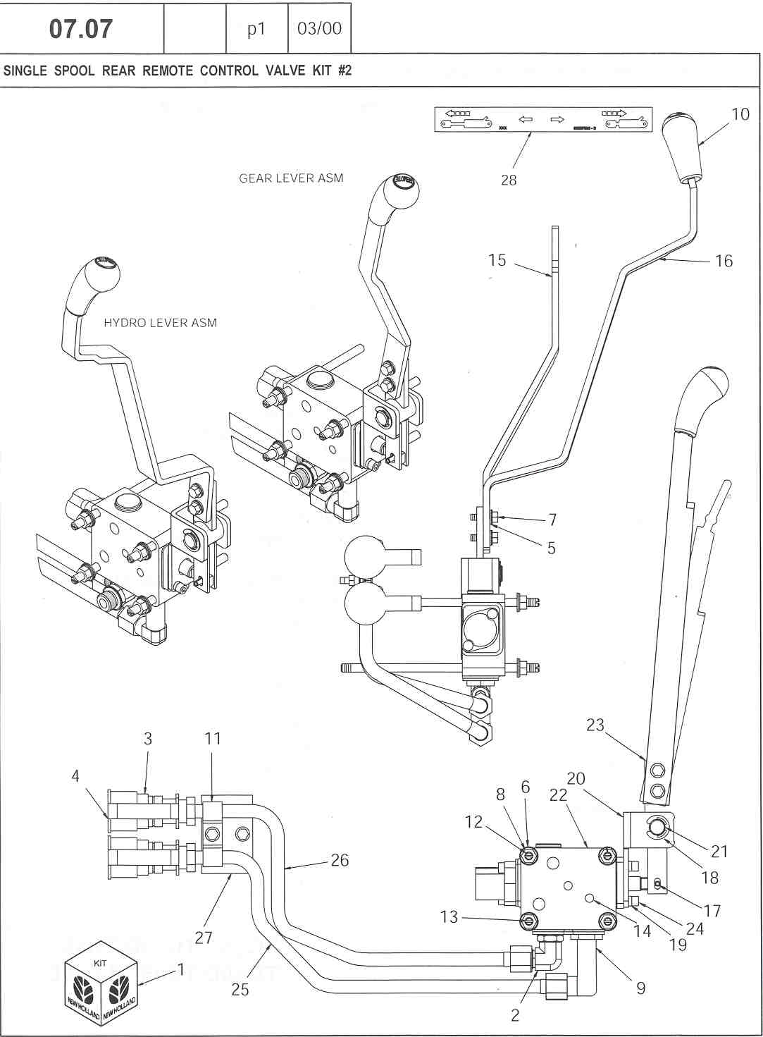

Finally, I included the illustrations that come with remote valve kits 1 & 2 so you can see what is involved with the kits. The kits are the same except the levers are different for the gear or HST tractors. It's a fun and easy job.
