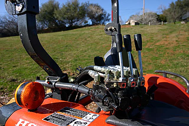

   / auxilary hydraulics #9
Yes it is the hoe ports. Since you cannot have the toplink on while using the hoe and needing the 3 spool valve while hoeing would be less likely, they are available to you. They all quick couple so ease of removal is fast. I did not have the hoe. My needs for hoe work is rather limited so I wanted the versatility of a 3 pt hitch with the abundant power of the L48's integral loader. Mine was so strong that on bucket curl I could lift the whole rear end off the ground when my tooth bar would lodge under a root. You do flip the lever on the right rear to the hoe position as I recall but leave the main quick coupler unused and its valve in the non hoe position. What in essence you are tapping into are the hoe swing hydraulics which also run the 3 pt hitch. I have a nice well made braket for the 3 spool valve body which is much nicer then mounting it to the fender. Heres a picture on my L3830 HST I took the other day after washing 50 lbs of dirt away.
Rat,
That looks like a Detroit Squid on steroids? I had no idea those things where so big on the fender. Will it interfear with the cab I intend to put on the L48?
Let me get this right? If I am using the backhoe then I can not use the auxilliary hydraulics? When the hoe is off, I tap into the main hoe lines and that is the system?
I will have to llook close before going for anything.
I am also looking at how this unit will fit with my planned seat lift/rotation idea? I know, wanting too much. Have to science it out and get it all if possible.
