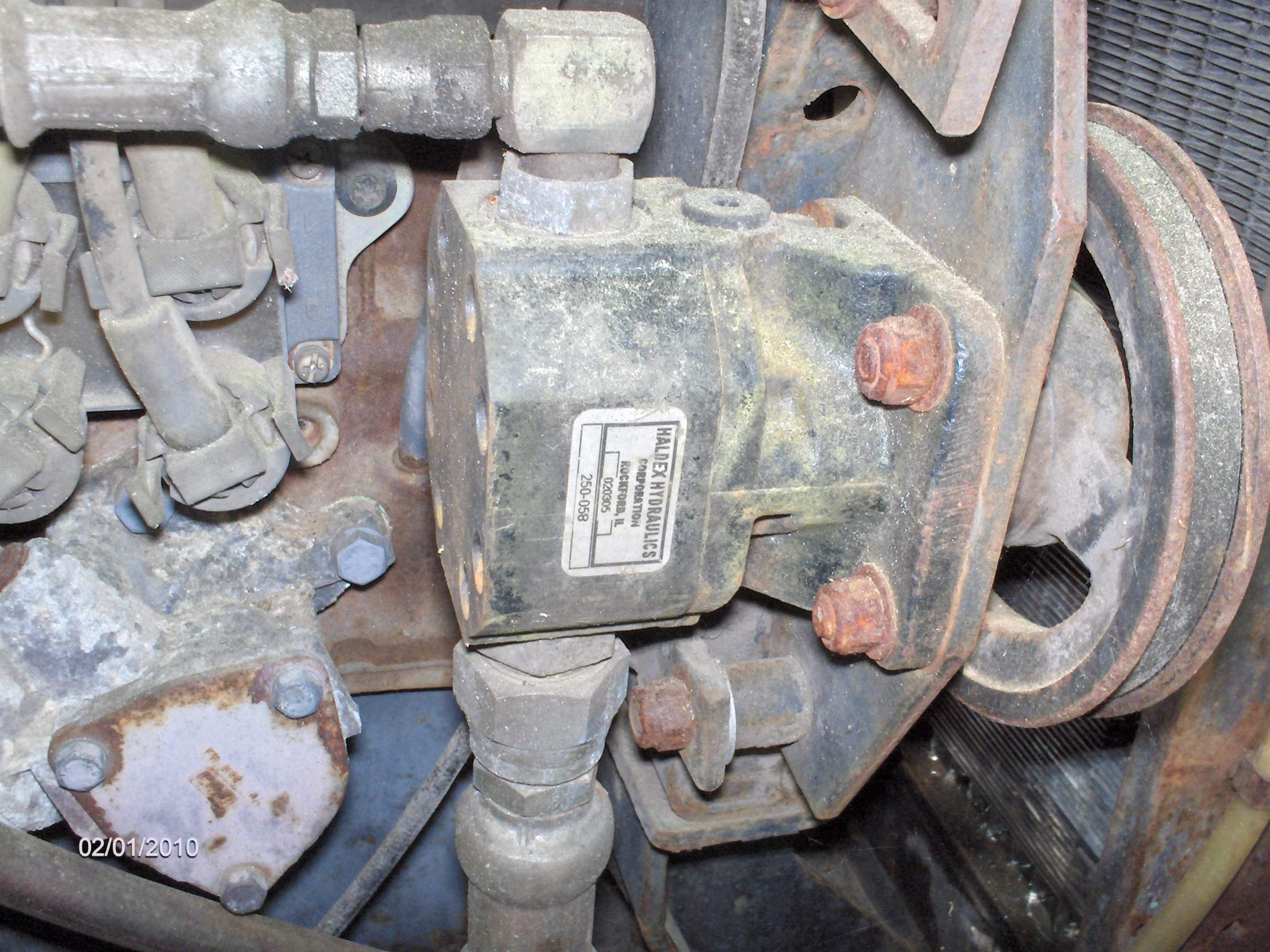

If your engine is a small 3 or 4 cyl diesel, then I would think it could handle the aux pump.
Here is a small hyd pump mounted to the engine of my 4 cyl gas engine on my Power-Trac. This is a Barnes 3000 psi pump, about 3 GPM's.
