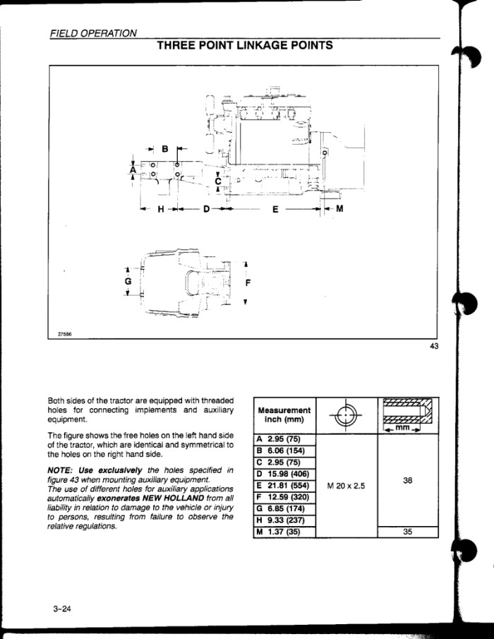

On the front of my TN70DA there is a cast piece of steel/iron below the battery that has 4 holes in the front and 3 holes on each side that are threaded. In the owners manual it gives dimensions of the hole arrangements. It also mentions that its used to mount auxiliary implements. But doesn't give any specifics other than hole arrangements.
Is it for a 3pt hitch up front?

I do have a brush guard on it. Not very impresive one, its the OEM type. So the brush guard holes are being use, there are still 10 holes threaded. They are 12mm, which is a good sized bolt and 10 of them. They have plugs in them at this time, came from the factory that way.

Attached is scanned page of the owners manual. This is the only page mentioning connecting implements and aux equipment.

   / Auxiliary implements for TN series #7
I guess the point is, if you need something attached to the front or side of the tractor, these are the holes to use.
So, what implement do you need?
Mid-mount sickle mowers, front mount row crop cultivators, frame attached loaders, flail mowers, belly mowers, weight or rock boxes, front wheel rake, front fert or herbicide tank, weed wiper tube, front hitch, buzz saw, front snow blower, brakets or supports for all sorts of orchard & specialty equipment, crop lifter for driving next to corn rows, and on & on. Seen it all.
They are telling you these are the holes to use, if you need to bolt something to your tractor. The possibilities are endless.
