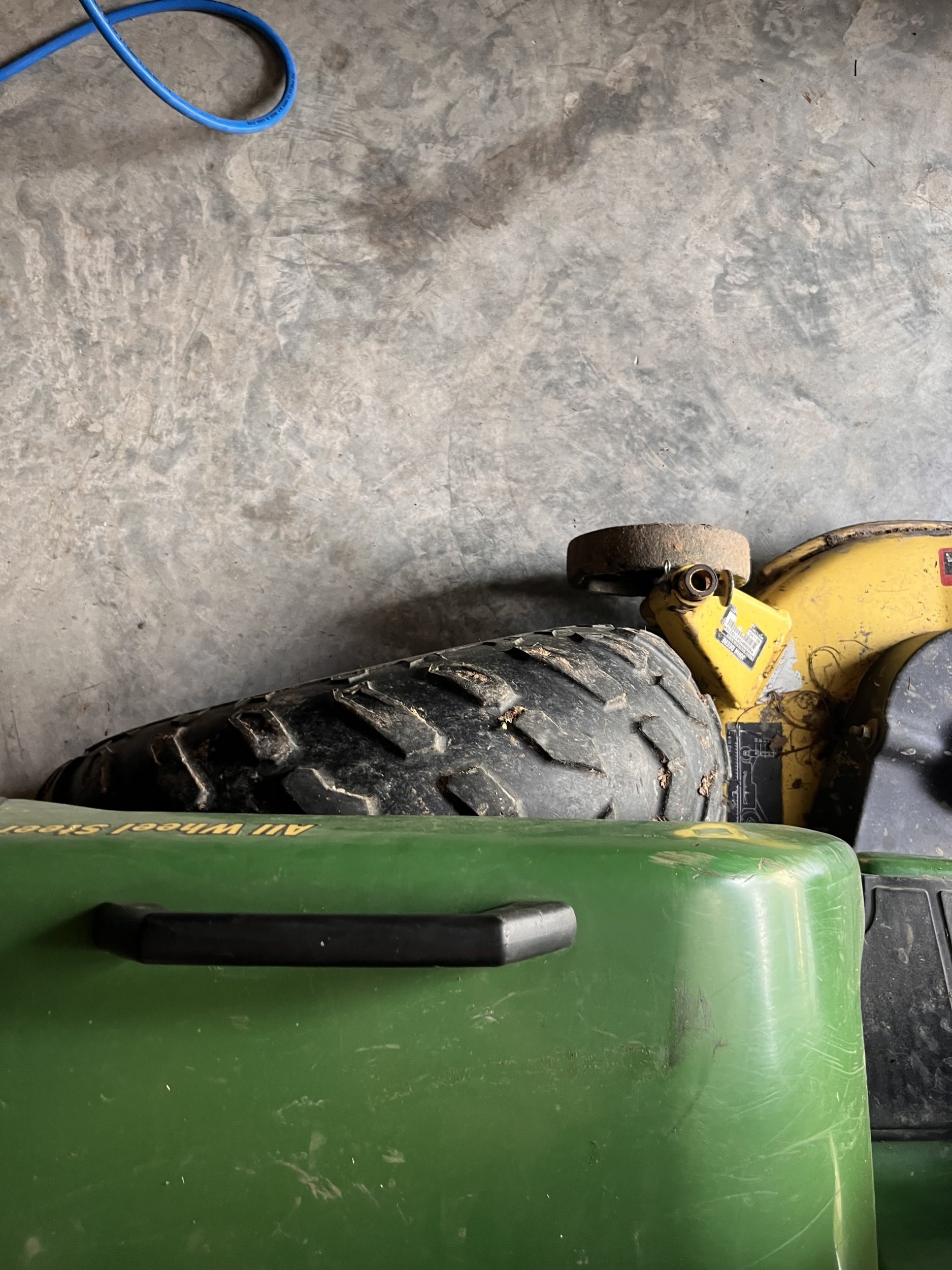

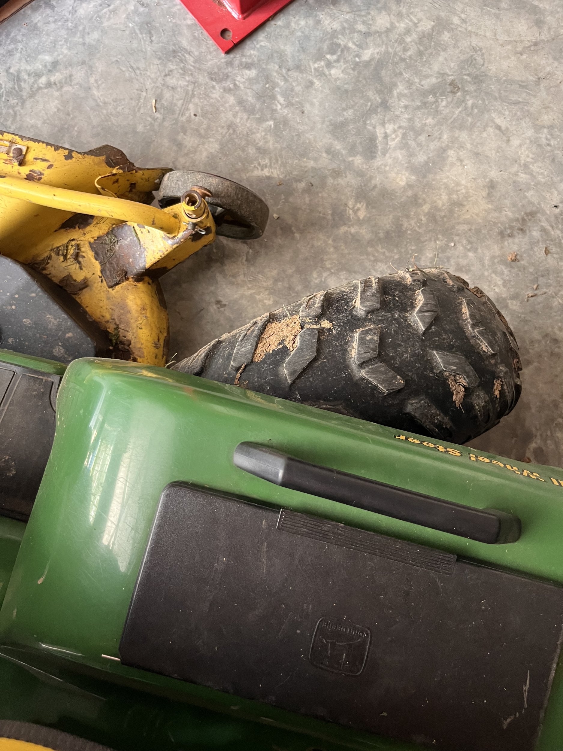

Aws John Deere 455
Aws 455 John deere
Love the tractor but have notice when turning that the left wheel doesn’t turn like the passenger wheel and new to know what to do to fix it. First pic is left side second one is right side.
   / Aws issues #2
It could be that you are looking at the effect of the wheel on the inside radius of a turn having to turn more than the wheel on the outside radius of the turn.
   / Aws issues #4
You may have some loose steering linkage. Slide the mower deck out so you can take a good look. There is an odd looking metal pivot point just ahead of the rear tires. Look for loose hardware.
