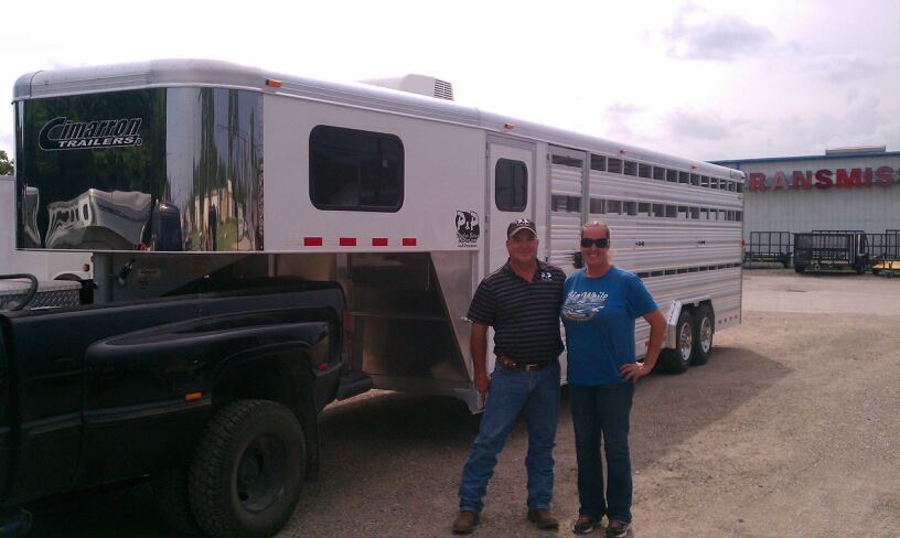

The trailer came in a couple weeks ago, and I thought I would share a couple of pics.
After speaking with a handful of people, including a couple of friends that are in the cattle business and happen to own large trailer dealerships, I was convinced to go with the 2-8k axles with 17.5, 16ply tires. The tires are rated for 6005# each, so they are quite a bit more than the axles are rated for.
Their reasoning for the lighter axles, is that the trailer will be loaded light most of the time, and the ride quality will suffer with the heavier suspension. I went with overkill on the tires, because I want good tires on my vehicles to handle the heat on the highway during our Texas summers.
I'll run this combination for a couple years, and if it doesn't work to my liking, I'll order another trailer with a different axle/tire combo.
