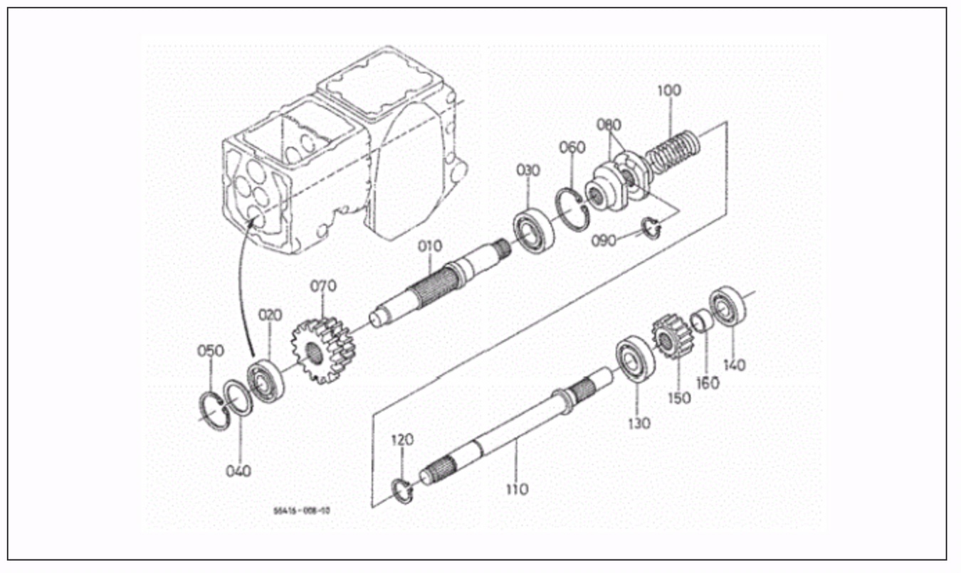

As the title states I just purchased a 4 foot Bush hog for my B1750. Just wondering if I need an Over running clutch?

I looked in the parts manual, and it appears that the B1750 has an internal over running clutch, listed as "Cam, one way clutch" (#80 in the photo.
I am not an expert, so I recommend you either test your setup, or get an answer from a dealer.

Well I hooked up the rotary cutter to the B1750 gear and took her for a ride. I do not need the clutch. Pro stops spinning when main clutch is depressed, therefore no forward movement of the tractor with the clutch depressed. It's a good thing because the over running clutch wouldn't have fit I would have shortened the PTO shaft.
