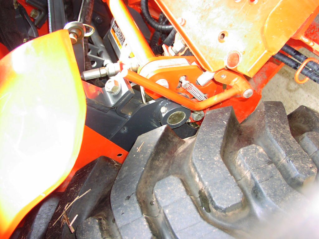

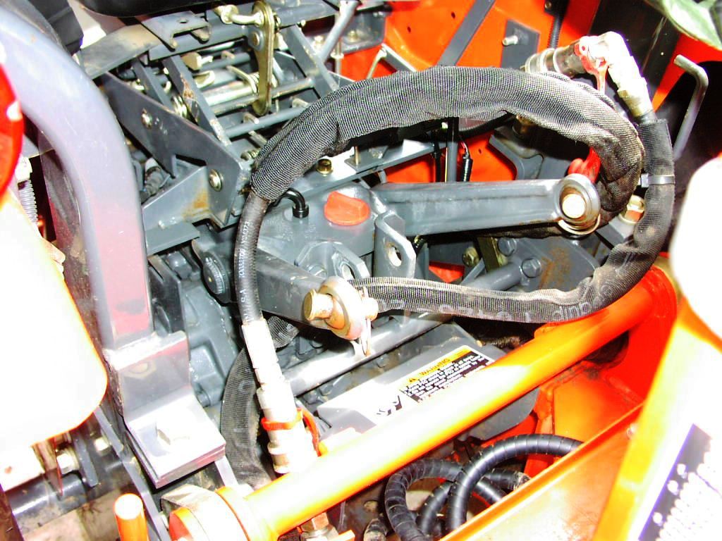

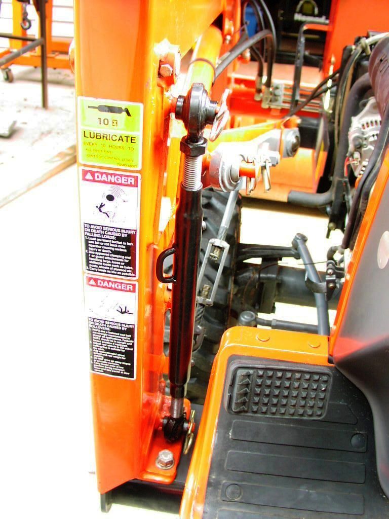

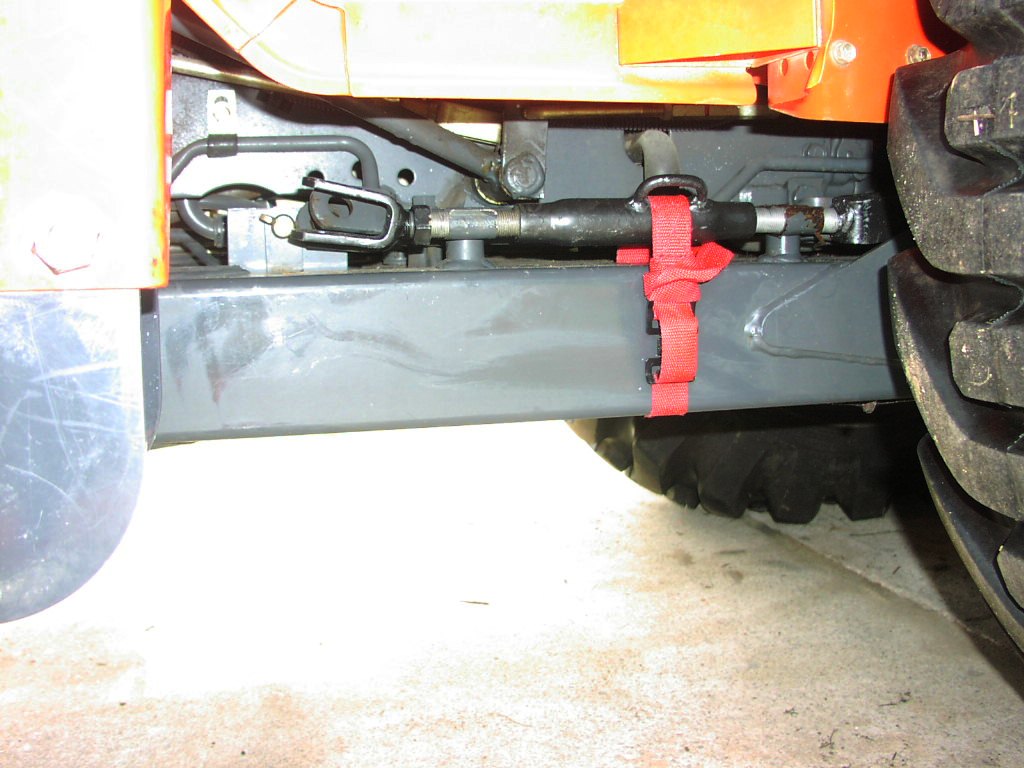

This is a 2007 B21, not positive if other years have the same features. To clarify a few things it has a 3 point hitch that stores in various places, the arms and top link are stored on the inside of the loader frame, while the side links are stored under the "cab" on the frame. The backhoe is quick attach the loader is not. There is a lever in the "cab" to switch between backhoe operation and 3 point. If anyone needs more pcis, I can post them, let me know.

Looks like it's in "as new" condition. Do your site prep work with it, maintain it carefully and you should get near 100% return if you should decide to sell it later for a different model. Good choice.
   / B20, 21 or ???? #10
Looks shiney and new!
The 3 point hitch storage is normal. My 2005 does not have a the quick attach backhoe bucket. That may be an option.
