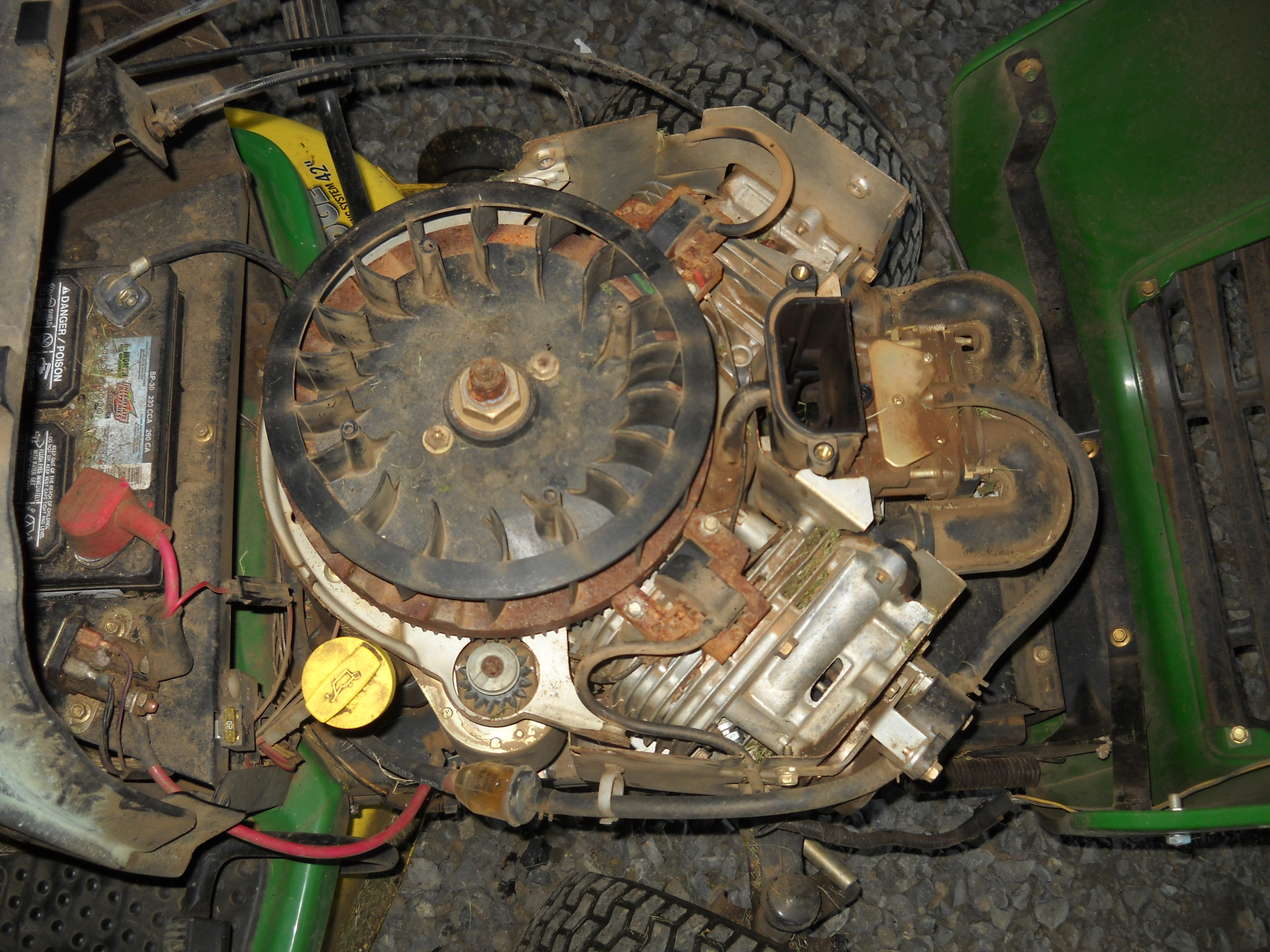

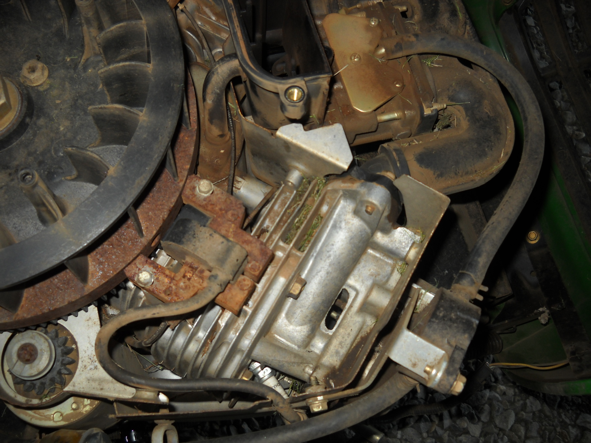

I have had mice problems in the past on my L118 JD. In fact this morning i was looking at my L118 and noticed that someone packed my ignition switch full of dirt! :mad: Nobody knows who did it so my assumption is someone was poking around and decided to disable my L118 as a cruel joke or something. I defiantly will check all the fluids after this incidence to be sure nothing else was messed with. So I flipped my hook open and saw a mouse nest on top of the battery (again). Them mice are awful, i have had two mouse nests on my battery and one that was up past the air filter between the plastic engine covering and the cooling fins on the engine. At the time i did take pictures of cleaning out the mouse nest under the plastic covering, I gotta check that area frequently which is fine since it is right under the air filter which I check frequently. :)
