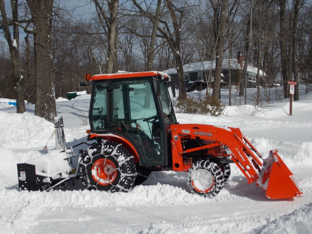

I would advise you to buy chains just for the front. This way, if you get in a jam on the job, raise the wheels with the loader and slip em on. Easiest and cheapest way to go.

The rears on my B3030 are loaded. The problem with a backhoe is that it is recommended you don't load the rear tires when the hoe is on.
I'm a big believer in chains and would always have a set for any tractor that I owned as long as I live in Yankee Land.
Forgot to say, I got beet juice in my rears. If I had to do it again, I would of foamed em.
