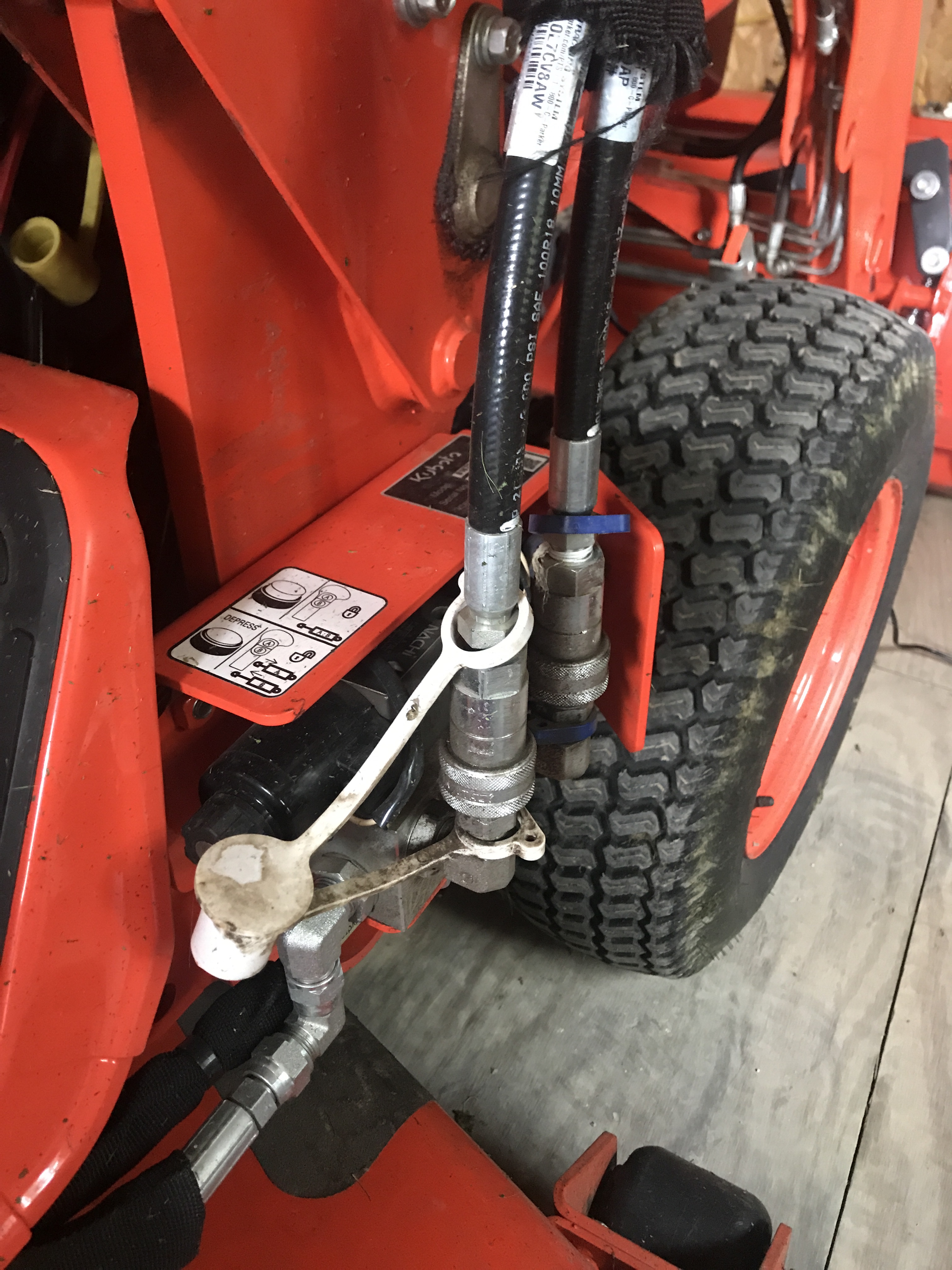

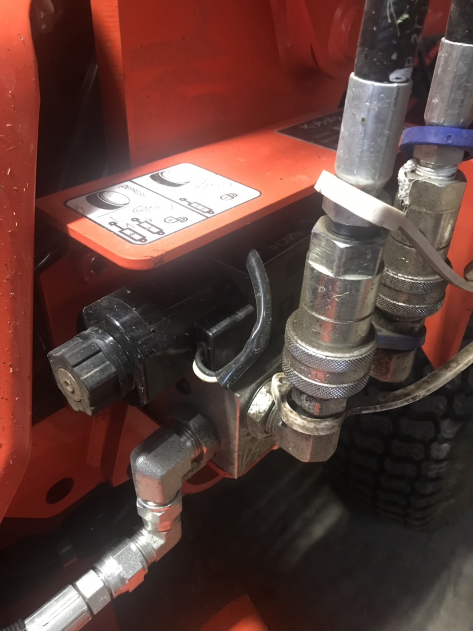

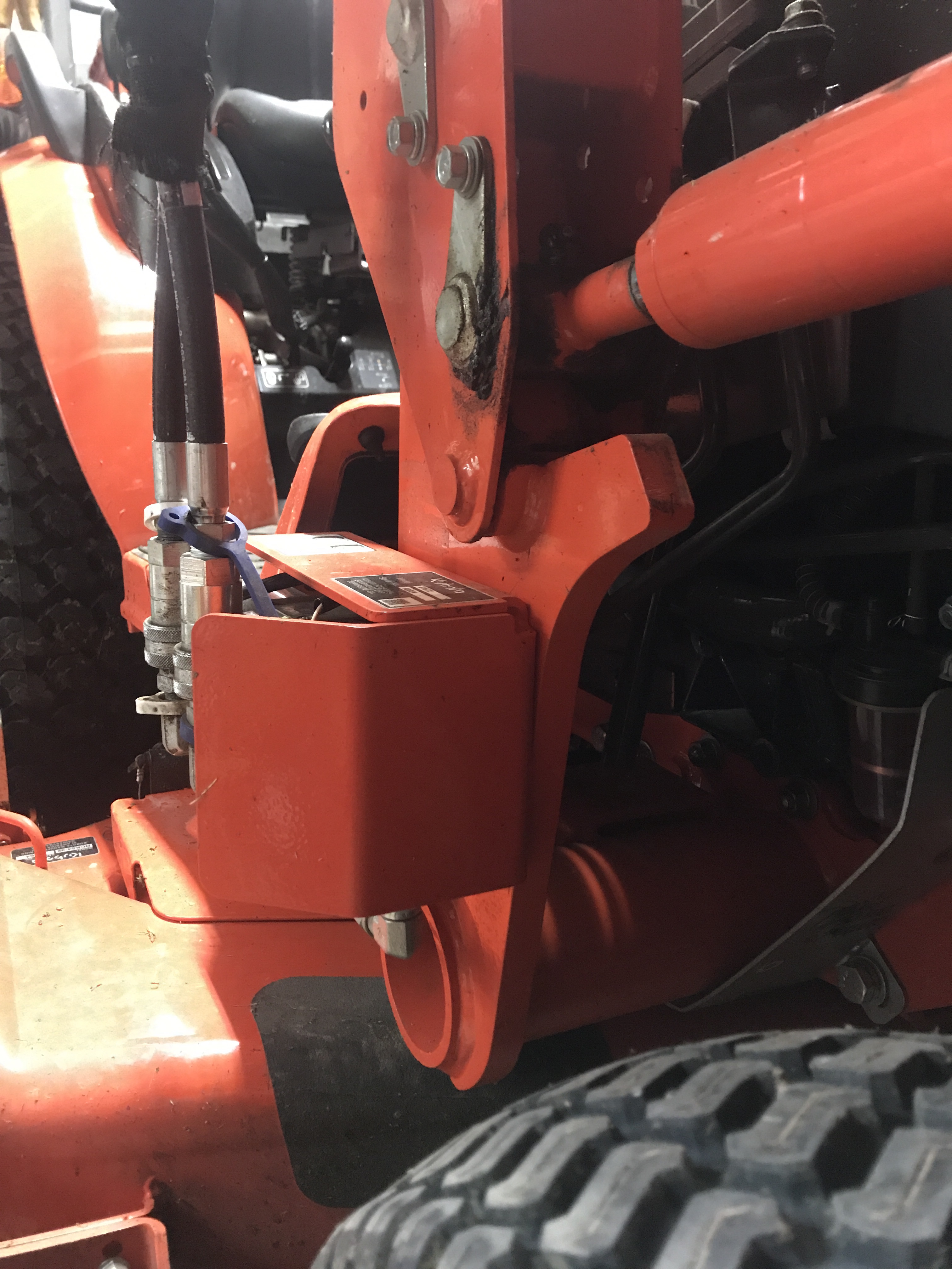

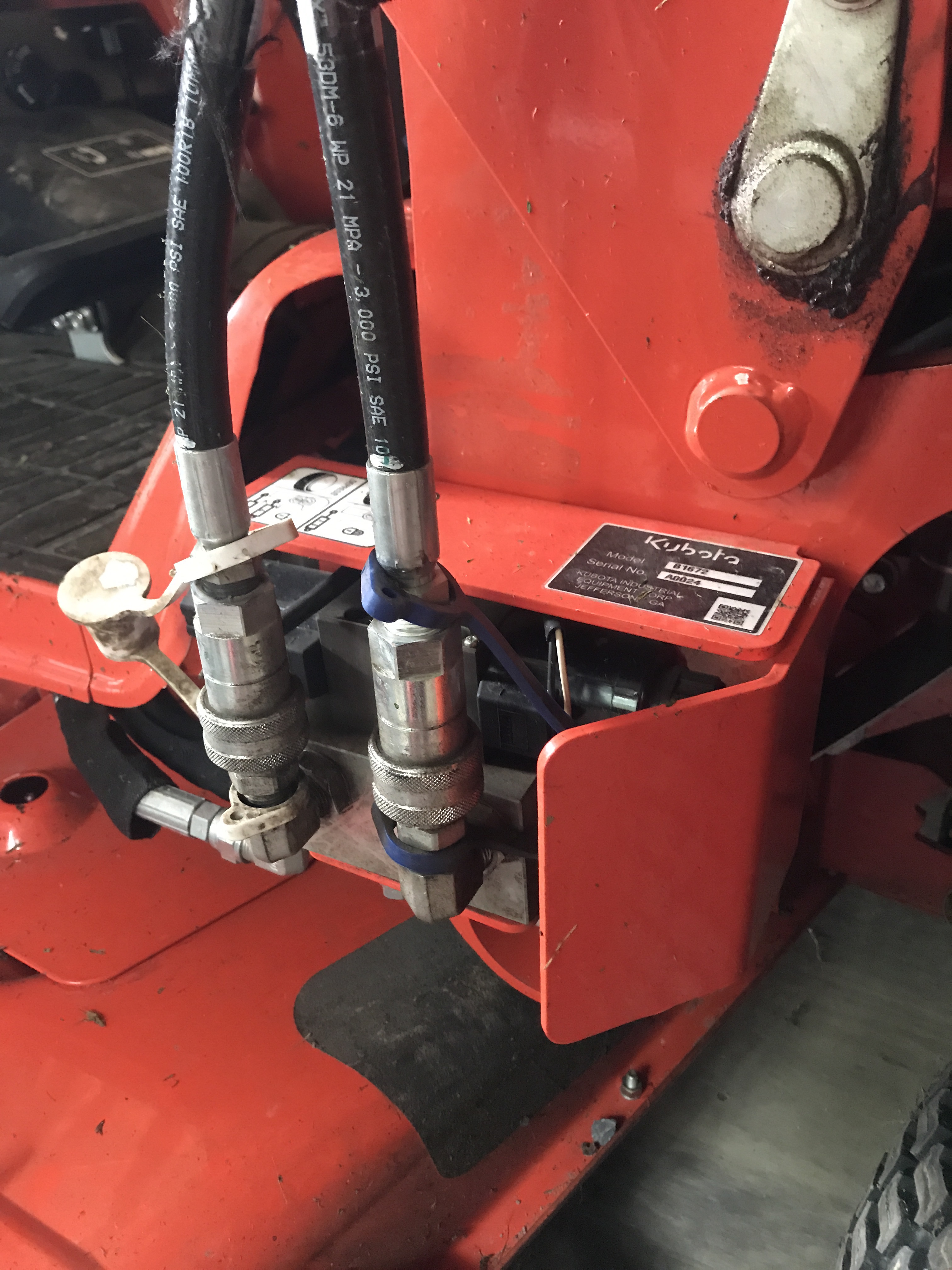

I have the LP 3rd function on my B2601 with 435 loader...the solenoid is mounted on the loader bracket behind a small guard on the right side forward of the floor board. It stays with the tractor after the loader is detached. 2 hydro pioneers from the loader then connect to that...obviously those couplers need to be disconnected before taking the loader off...
The Kubota part number is also the Land Pride unit...

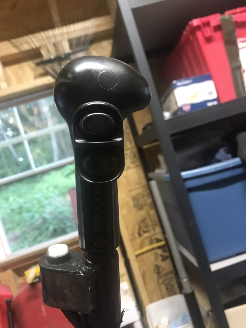

If you find the time, could you post a pic or two of the LP joystick controller. Whether it be a Kubota or Land Pride kit, I have yet to discover a clear picture of the control.
Thanks, in advance.

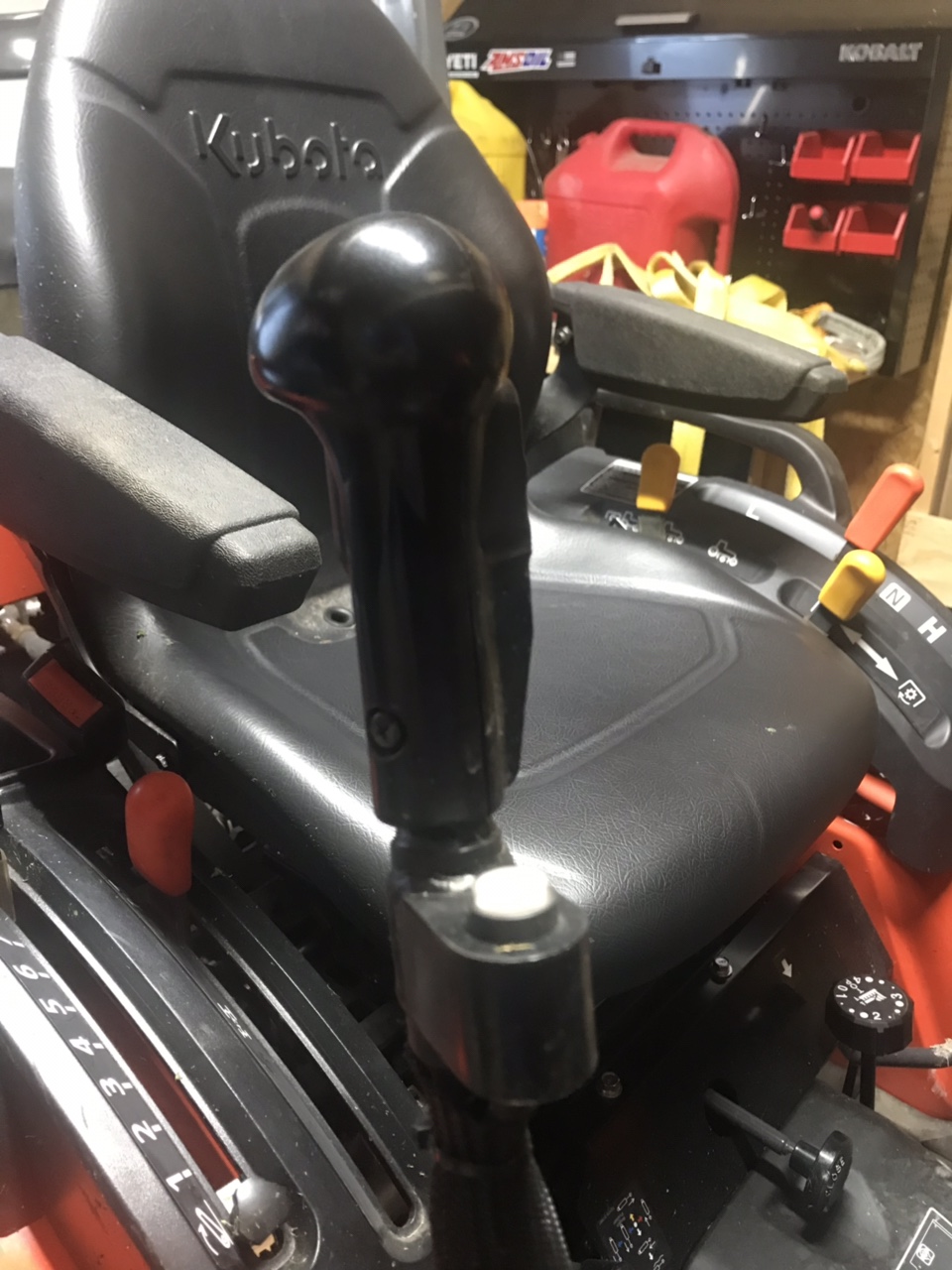

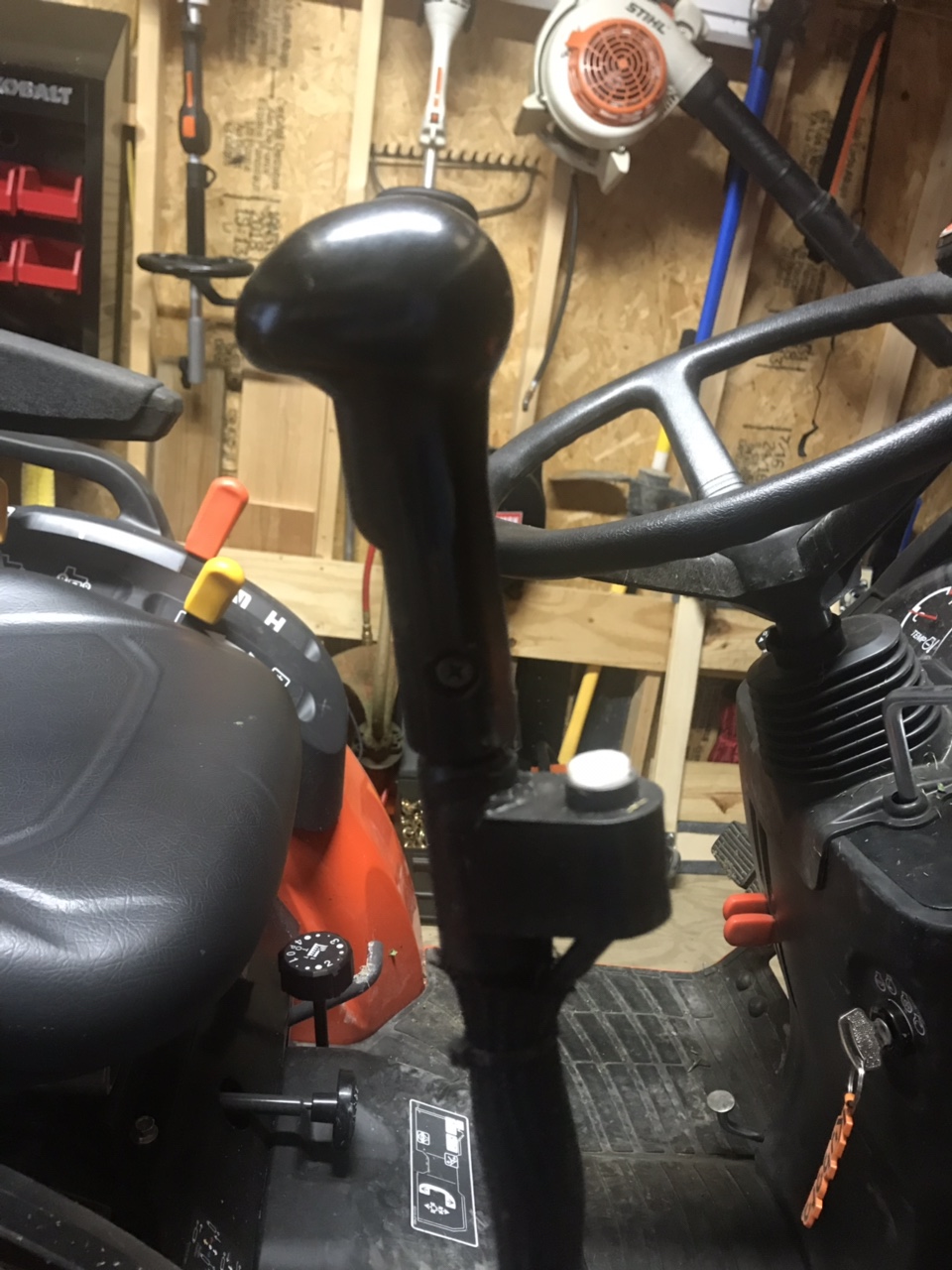

I apologize it took me so long to get these photos of the hand control you asked for...
Also, while I was doing the research on buying my 2601, I am quite certain I read on another Kubota forum that the LP and Kubota 3rd function are one in the same! It could certainly be different...

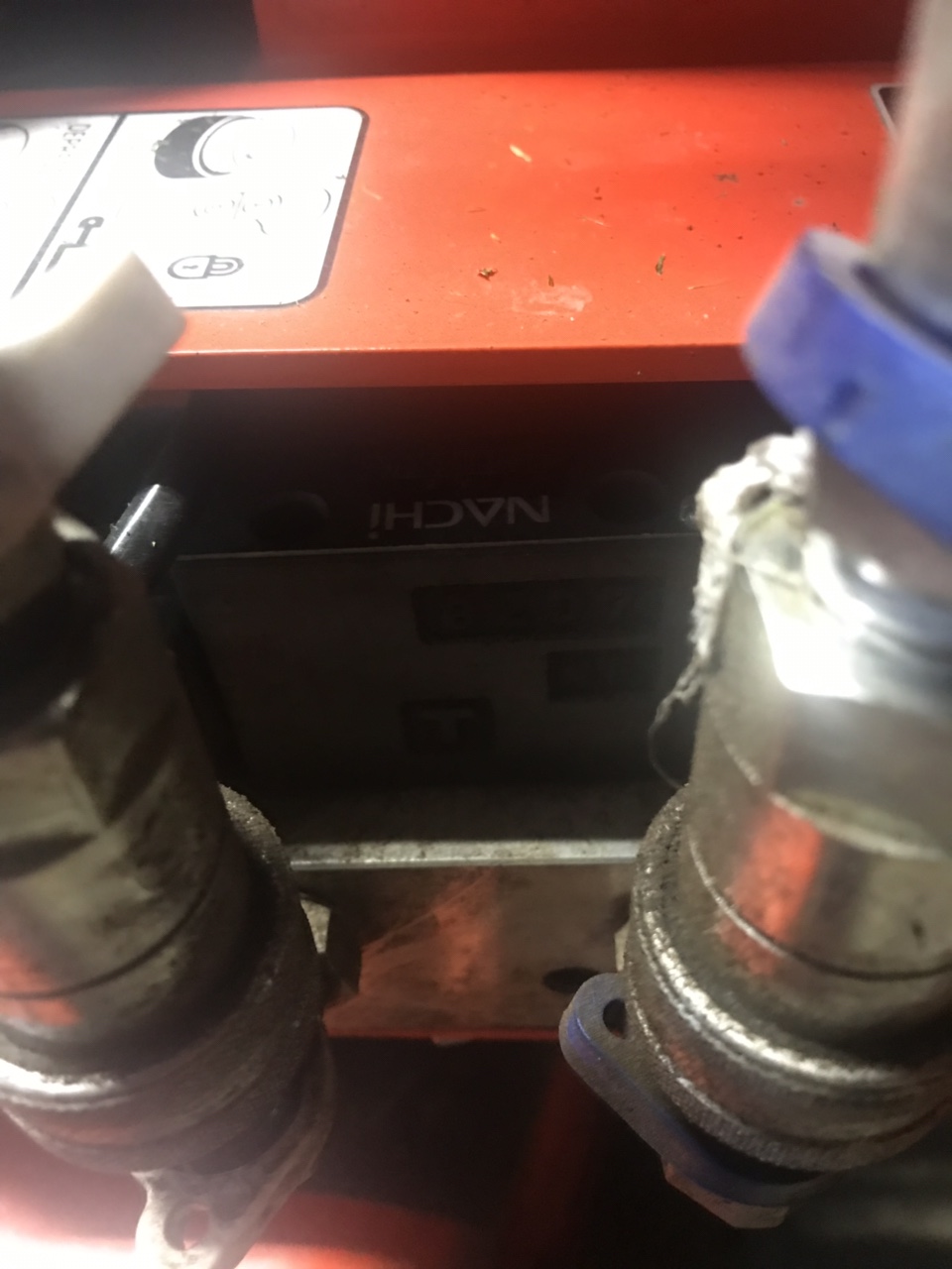

I figured I would snap a picture of the electronic control unit under that guard on the loader bracket

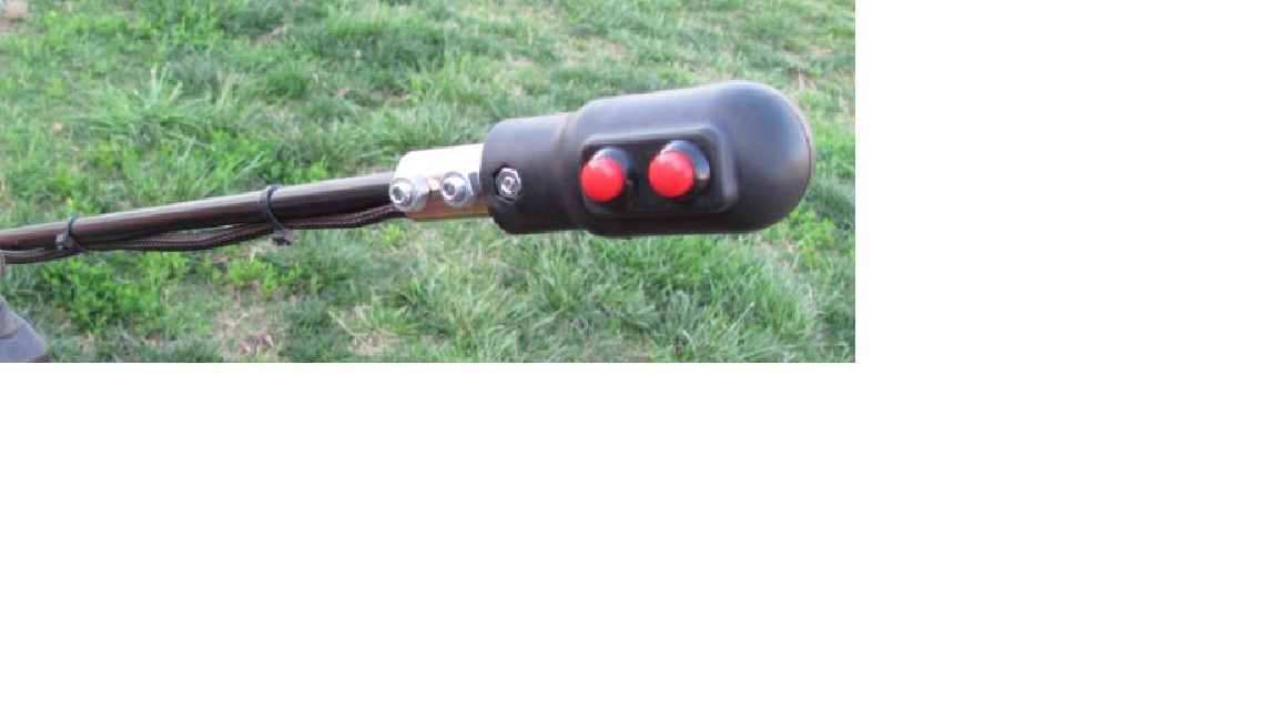

troopr31, Thank you for the pictures! I'm still confused! I am under the impression that the LP 380-149A joystick controller looks like this:
That picture was taken from the dealer training slides, posted above by beep chirp whirr.
From what I have scene on the web, your controller looks just like in the Kubota B1672 kit
