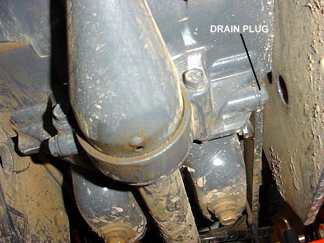

Would someone be so kind as to post a few pix of these water drain plugs??
Thanks........
Swmpbgy1
   / B2630/3030 Transmission Water Drain #8
This was taken from under the tractor, from the rear, looking forward. The drain plug is on the left side as sitting in the seat. There is a hole in the frame so that you can put a socket on it.
Hope this helps, David
#9
Negative, mtrain. You've got the drain correctly identified in your picture, but sitting in the seat looking forward, the drain is on the right hand side of the tractor.
