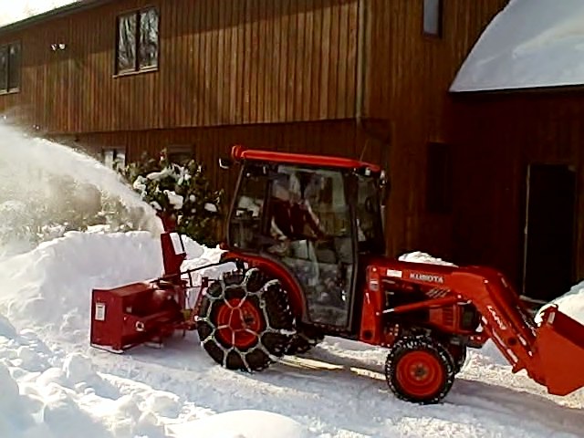

I think it's prudent to change it every 5 years. Oil breaks down, even when not in use, due to temperature fluctuations and moisture build up.
