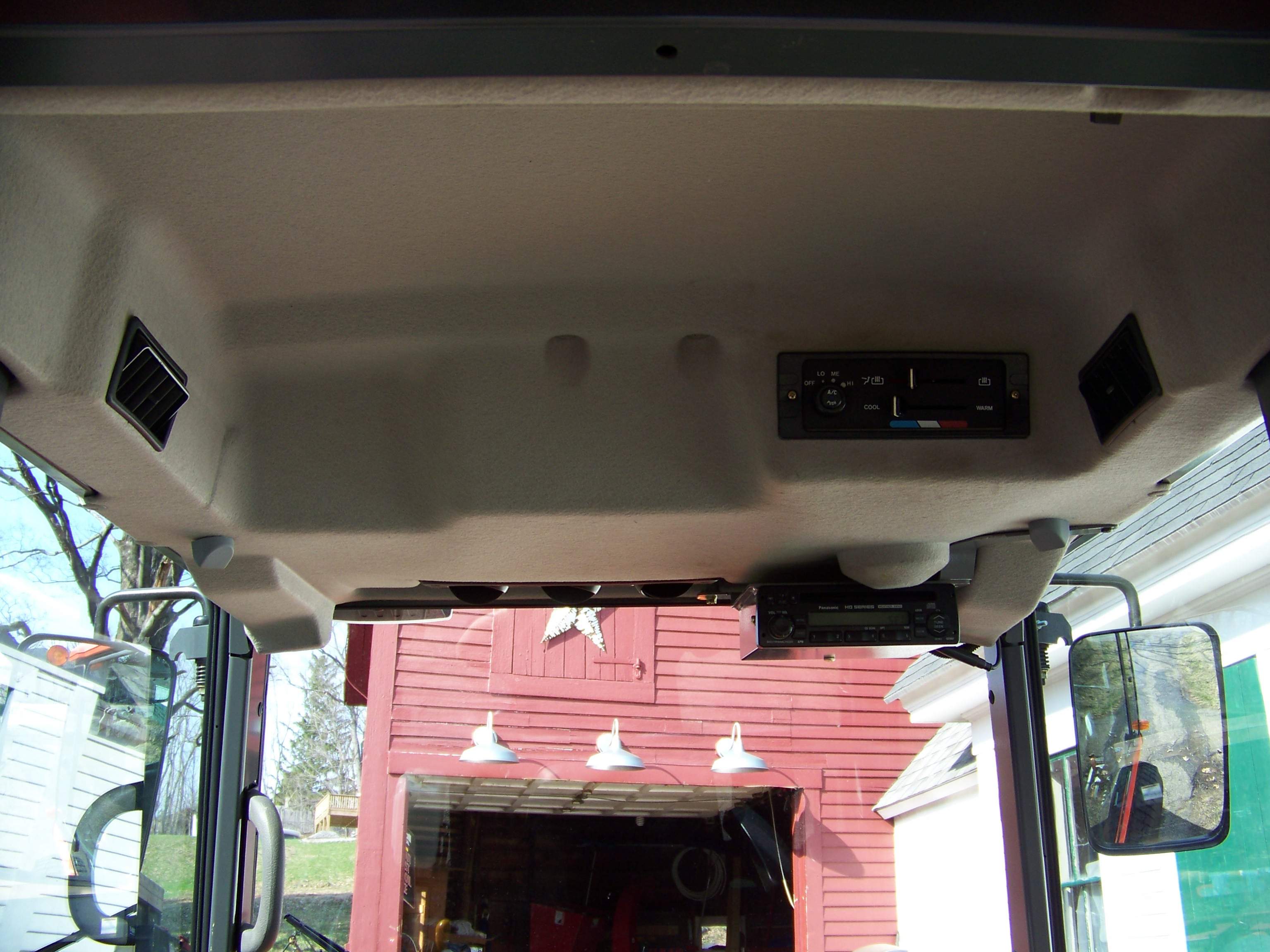

I have had a hard time finding good pics of the interior of the cab on the internet so if you could post some I would appreciate it.

Not alot of interior pics, but here's a few.........
