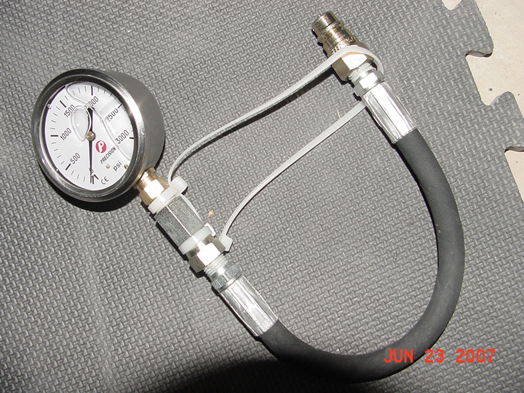

You should get simple gauge setup, and see what your PRV (pressure relief valve) is currently set at now...Kubota has a history of them being low from the factory.
You can make one for about $35.00 or less, see my picture below. I have since replaced the 12" hose with a 36" hose to make it easier to use.
Just happened to be searching the site and stumbled upon a post from Feb. 2009 when I was shimming the JD 790 that I had at the time. Many posts there from both of us!
I did in fact make a gauge back then and it still sits in my tool box. Next step is to check the stock setting next time I have the tractor out of the barn.
If in fact it could use a boost, will this address the issue that I mention in the original post? I don't really want to max it out, but what does anyone recommend for reasonable PSI? If shimming does come into play, can someone chime in here with a Kubota part # for me? Much appreciated!
BTW, this is a low (65) hour tractor. I would hope that there are no worn springs, etc. in the valve. But of course there are never any guarantees.

Well good...so see what you have now and compare it to the specs.

If I got off the dupa I'd already have used my gauge. :laughing: Hard to get much done when it gets dark so soon after work. The pellet stove, recliner and faithful golden retriever at the feet don't make it any easier. ;) Maybe when the QA stuff arrives from Washburn I'll kick things into gear a little quicker.
Looking at my shop manual, the relief valve appears to be just ahead of the right side (looking at tractor from rear) lift arm. It states that the relief valve setting pressure on a B3030 should be 2204 to 2306 psi at rated engine speed and oil temp at 122° F.
The setting is 1920 to 1991 psi on a 2620 if anyone with that model is following along.

Wouldn't you know it? Went out to check tonight and the quick connects aren't the same size as on my former tractor (JD790).
Local NAPA ordered the correct fitting to crimp onto the gauge hose and an extra female QC like is on the loader hydraulic lines to screw onto it. Will post when I get the pressure checked.

OK, here's what I have:
Shop manual shows the relief valve on right side of tractor just ahead of the lift arm. The section mentions implement control so I believe this is what I want to check. Recommended pressure is 2204 to 2306 psi.
In another part of the manual it mentions relief valve for 3 points (their wording) hitch. Relief valve pressure there is shown as 2175 to 2320 psi.
Which one am I looking to check for the loader? At any rate, my gauge showed an even 2500 psi where the loader lines connect. This has not been tampered with by me. It came from the dealer as is. Sounds like the whole shim thing is moot for me now.
