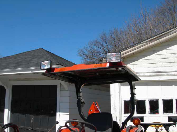

Sully2, I went one extra step with my lights by buying a canopy, to mount them to, and after last winters heavy snows, and the need to do some night work I am happy I did. By mounting to a canopy all you have to do is drill through fiberglass to mount your lights, your switches are all handy and out of the weather, the front work lights are 30 to 36 inches forward of the ROPS which gives you a lot more light for FEL work. Last but not least you don't get rained on. I'll post a few pics of my setup.
