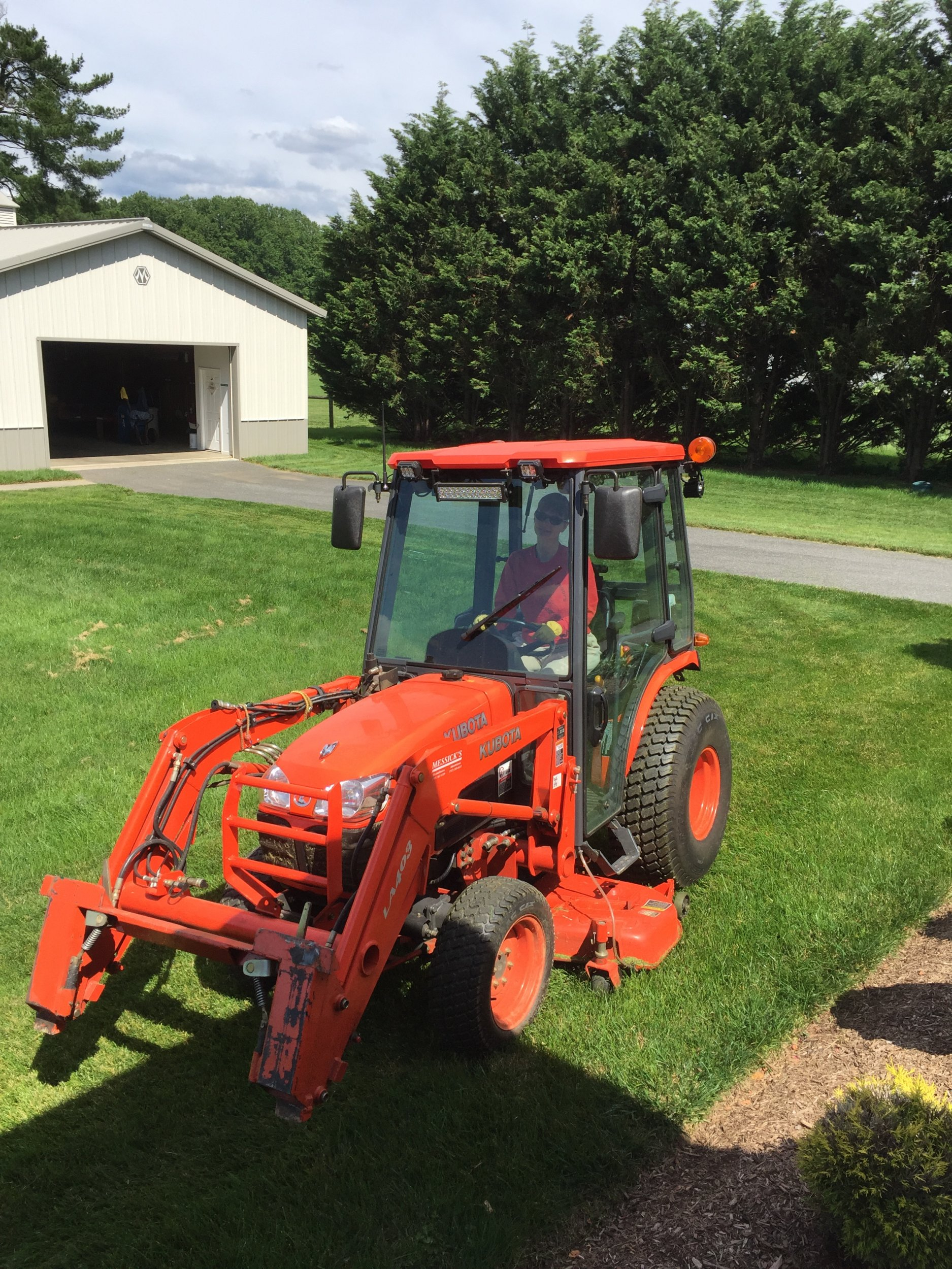

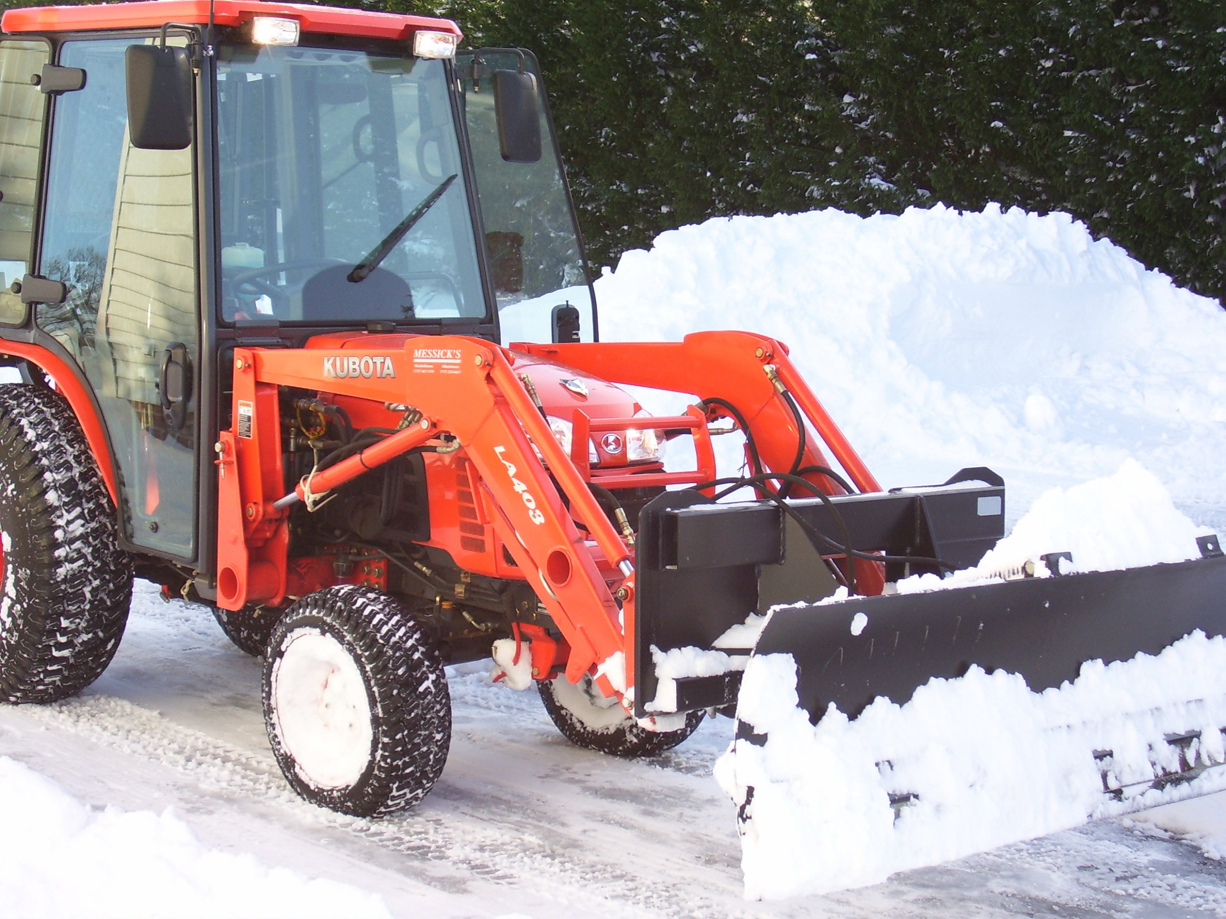

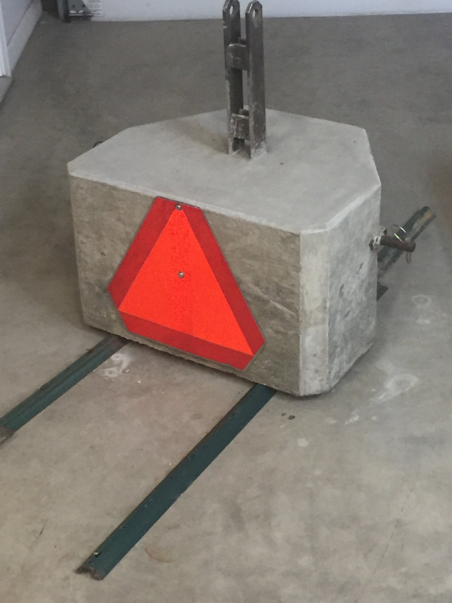

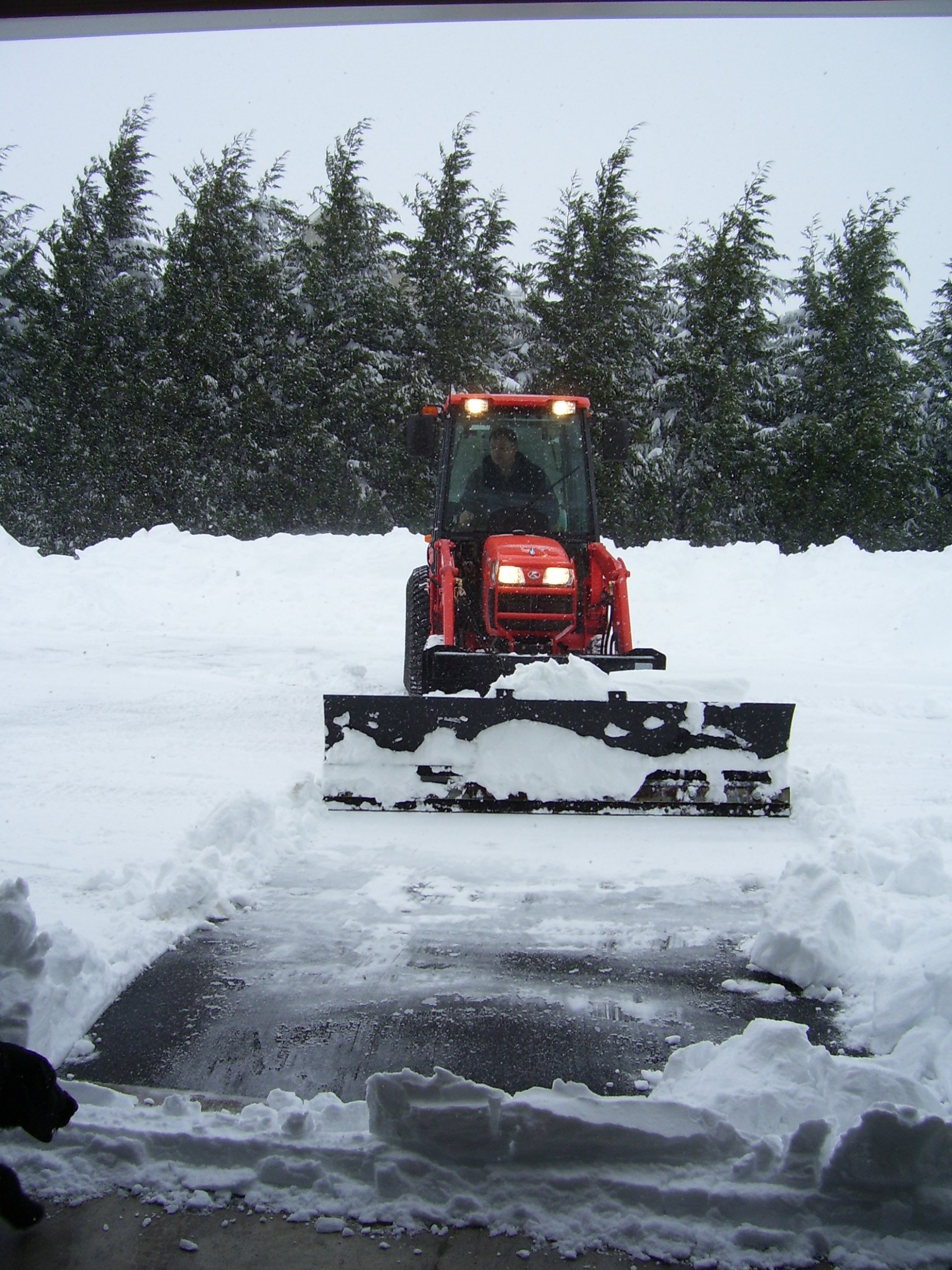

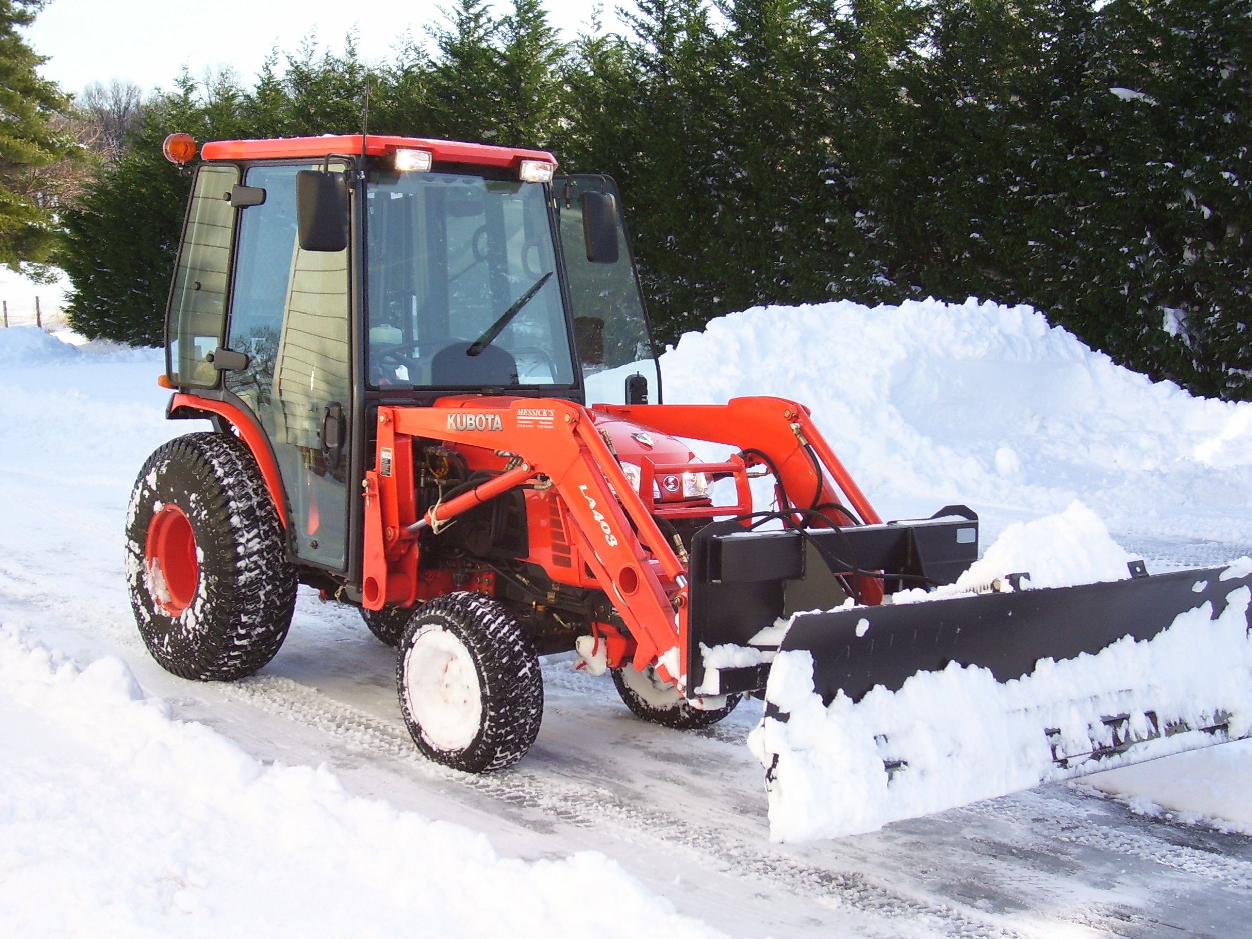

I also have a B3030 cabbed tractor that I use to mow 3 acres and move snow in the winter. I have the original turf tires and think they are great in the snow. My rear tires are liquid filled and I use a rear weight weighing approximately 700 lbs (+/-) which helps with the front loader attached snowplow. I know they have a new tire out now (I think it's a R14 tire or something like that) but don't know how good they are at mowing or plowing, maybe check with Messicks Kubota out of Pennsylvania. Some old pictures of the tractor.
