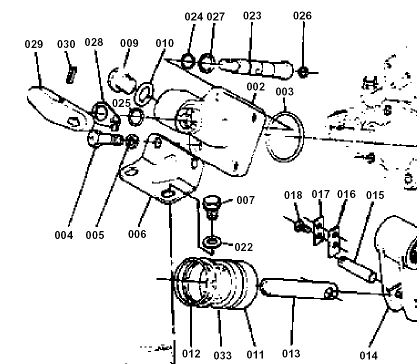

happy new year everyone.i want to fit a tipping pipe to my b5100 .although it dosnt have a diverter valve under the seat it has an outlet thet is blanked off.does anyone know if a tipping pipe can be tapped in here and if the trailer will tip when the tpl has reached the top or could this damage something in the tractor.Failing this is it possiable to fit a diverter valve and where can they be got?

Thanks charles tried connecting the pipe and when 3pl lever is raised oil flows but the linkage rises if there is more weigth in the trailer than on the linkage .When the linkage reaches the top it automaticly pushes the lift lever to the down position thus stopping the tipping so looks as if i need to fit the diverter.the valve isnt shown in detail on the owners manual so unsure if the valve at tractorsmart is everything i need as in cover or not.Asked local dealer and he has no info on such an "old tractor".located in ireland so dont want to pay shipping charges to find out i am still short more parts.any further help greatly appreciated

Yeah thats pretty much what I would assume happens, which is why they make the cap/valve.
Here is a pic from the parts manual of a b7100 with a clip from the parts list below that. I believe it includes the cap, lever and 'spool' assemblies. Appears to be everything you need with the assumption that the b7100/6100/5100 all use the same parts.
The part you don't get Ref. 26 is a little o-ring that is similar to what is already there but has a different part number so you might need that: 04810-05110
You also might want to change the o-ring on the piston while you are ordering parts and have it apart: 04810-08500. If implements on the 3pt take a while to leak down you might not want it.
