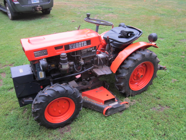

I am looking at a B6000 with mid mount mower. It appears to be in great shape but I am wondering about the quality of the grass cut it would provide.. I am coming from a lawn tractor; specifically a John Deere la145. I need a heavier tractor for plowing snow and hauling wood. The ccw pto really isn't a factor for me. How nice a cut does the belly mower provide?
   / B6000 with mid mount mower- Does it provide a good cut? #2
Might do a fine job of cutting grass, but if you have any need of using the PTO it turns backwards to most all other tractors. You need a reverser to use anything on the PTO.
A reverser is very difficult to find and expensive when you do.
