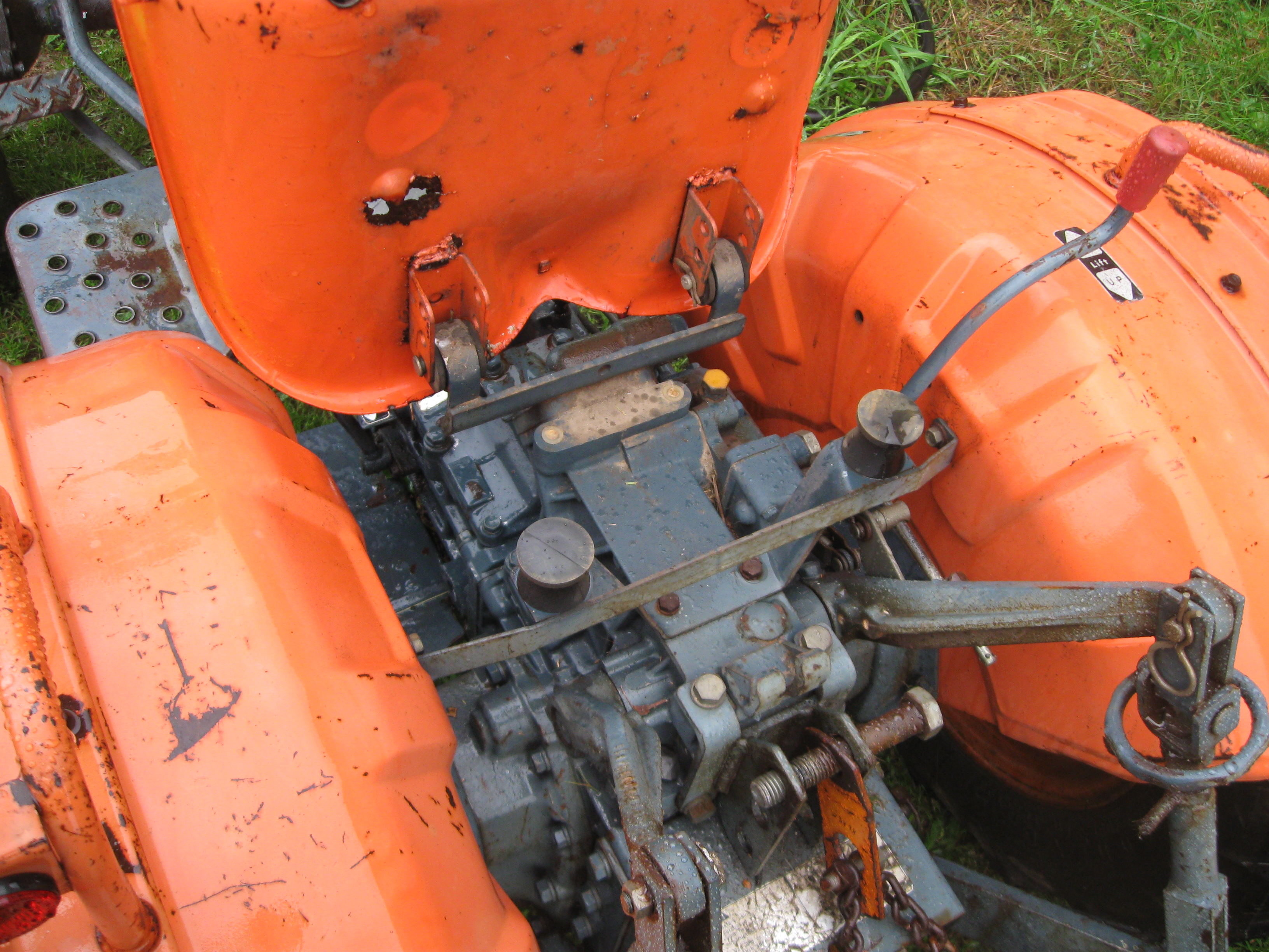

Kubota B7100. I need a replacement seat. The old seat pan is rusted through. This particular tractor has a pivot bracket in the front, so the seat will fold down over the steering wheel, and a bracket in the rear which has two rubber cushioning pillars. Also, that rear bracket spans the distance between the two fenders and bolts to them.
Will the suspension-style seats, like the one from Tractor Supply work on this without removing the cross-brace?

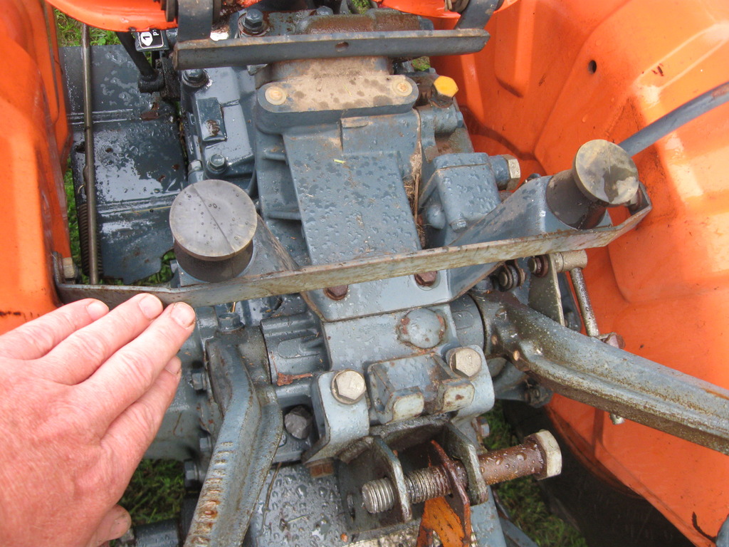

You can see the rear bracket has two purposes, support for the seat and brace for the fenders.
I see that bolt working its way loose.

Yes, the seat rests on the rubber pillars but they are mounted to a swivel plate which replaces the rear fender bracket. My seat was designed to swivel so it faces to the rear to use a backhoe. I'd post a pic but I traded the tractor several years ago.

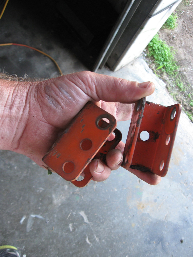

I did what you propose to do. I used an air grinder with a small wheel to cut the bracket welds off the old seat. The welds were pretty sloppy to begin with and it was easy to do. I was able to drill holes in the brackets and screw them to the pre tapped holes in the seat. It took a little time to get them to line up properly though.

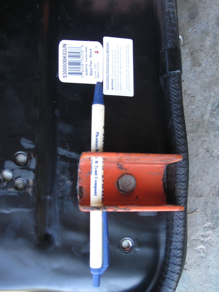

There was already one bolt hole on the old Kubota seat brackets which I cut off the old pan. This hole is perfect for attaching the bracket to the Talon seat, except that the bolt head prevents use of the middle of the three pivot pin adjustments because it impinges on the bushing holder.
There are two places on the seat bottom the bracket will bolt to. I experimented. I ended up using the most forward bolt hole pair, with the rearmost pivot pin location. That is about a middle position in respect to the tractor.

Brackets cut from seat, to be bolted to new seat so it will fit the stock pivot system. You can see the existing hole I will use for the fastener bolt, on the right bracket:

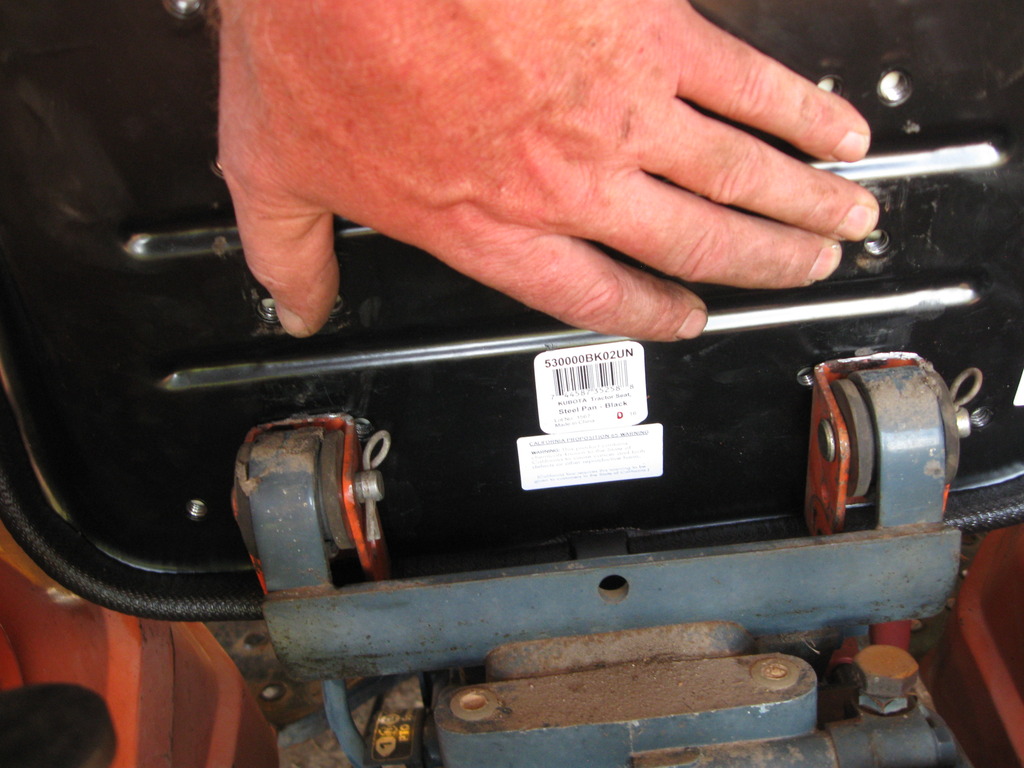

Bracket mounted in final position showing holding bolt installed. Pen shows which position where I am going to set the pivot pin. Note how tight it is against the seat lip. I had to clearance the bracket there some to get the bolt hole aligned:
Bracket and seat installed in final position. My fingers are pointing to the other pair of seat pan holes I could have used to mount the bracket. That option would have either brought the seat forward about as far as it can go, and rearward, about as far as it was originally designed to go:
