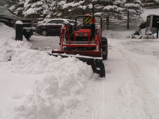

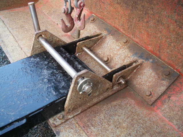

I had B7100HST for 14 plus years and can't say one thing bad about it..except no power steering.
Have you consider attaching plow to the bucket
