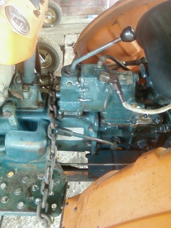

Anyone know what this thing is? Its on a B7100 thats on Ebay right now. I have never seen one before.

My first thought was an add-on hydraulic pump... and looking at the other pics confirms it. Looks like it runs the blade. It would appear to be factory from the way it fits. Not sure why they did that and not a front PTO pump... unless that pump would be in the way of the cylinders for the blade. Interesting to be sure. Somewhere maybe there is a parts manual for that b205 blade.

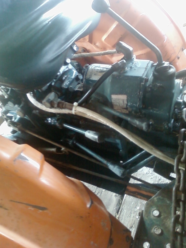

I have a B7100D 6 speed manual trans with a hydraulic blade.
There is a mystery box mounted on top of my normal transmission that feeds the blade and has a lever on the side. It also has a diagram showing various combinations of "creeping speeds" vs. High Low settings.
I assume that this means the lever works in conjunction with the High-Low lever somehow.
Does anyone know what this mystery box is called and what it does?
It seems that it not only feeds hydraulics to the blade, but also affects my transmission gears.
I can not find any mention of this option in any Kubota manual. But, it looks like a genuine Kubota part.
Thanks for any light you can shed on this.

I posted on your other thread that I believed it was an add-on PTO pump. If it also affects your gears maybe it is also an additional split-range tranny somehow?

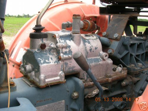

OK, I know I'm about 3 years late, but I have one too.
Did anyone ever figure out just what it is?
Is it Kubota OEM?
Does it have a name?
Does it have a manual?
Just what is this thing???

being that this is my first b7100, and I have one of these "things", i am not sure how to compare the gear speed with "normal" but, i can tell you when I put this in "creeping" low, it goes real slooooow.
the decal has a matrix of "creeping" positions vs LO vs HI. still have not figured out what the diagram is trying to describe

My Yanmar F24Dhas creeper transmission. It can be used with any of the normal gear ranges. With it enabled, the ground speed drops to anywhere between a crawl and barely creeping. Mine isn't mentioned in the manual either.
I bet that the hydraulics are not affected by the position of the creep lever.
/ B7100 trans question #17
Re: B7100 mystery box - what is "creeping speed" on transmission
yes, you are right, althought the hydraulics for the dozer blade are tapped from this add-on, the speed of the blade movement does not seem to be affected.
i am beginning to think this add-on has nothing to do with the blade except that it is a convenient place to tap the hydraulics.
