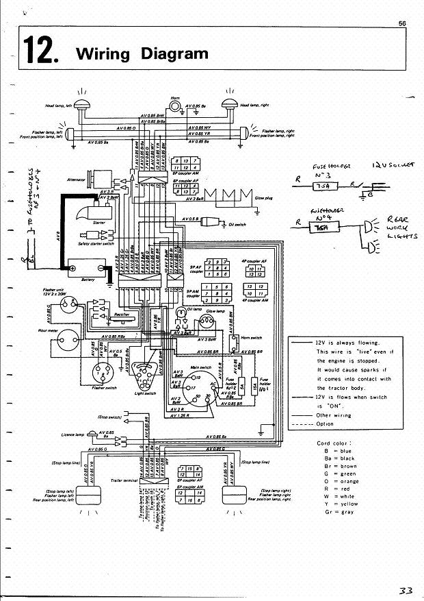

I recently had a rodent make a nest under the hood of my B7100. It chewed thru the wiring harness. I've rewired all except 2 wires. Since I don't have a wiring diagram I need a little help to verify how the last 2 wires connect. One is the red wire from the rectifier and the other is the red wire from the flasher. I think both go to the hot terminal on the ignition switch but would like verification or a copy of a wiring diagram would be helpful.
Thanks.
   / B7100 Wiring problem #2
HI there.
attached is a copy of the B7100 wiring diagram. I have sent it as a photo jpeg, , the hand writtten bits are my additions to the tractor so feel free to ignore them
I hope it helps
Mat

Thanks to Mat for the wiring diagram. I am back in operation. Just in time since we had 5-6" of snow today.
Bob
