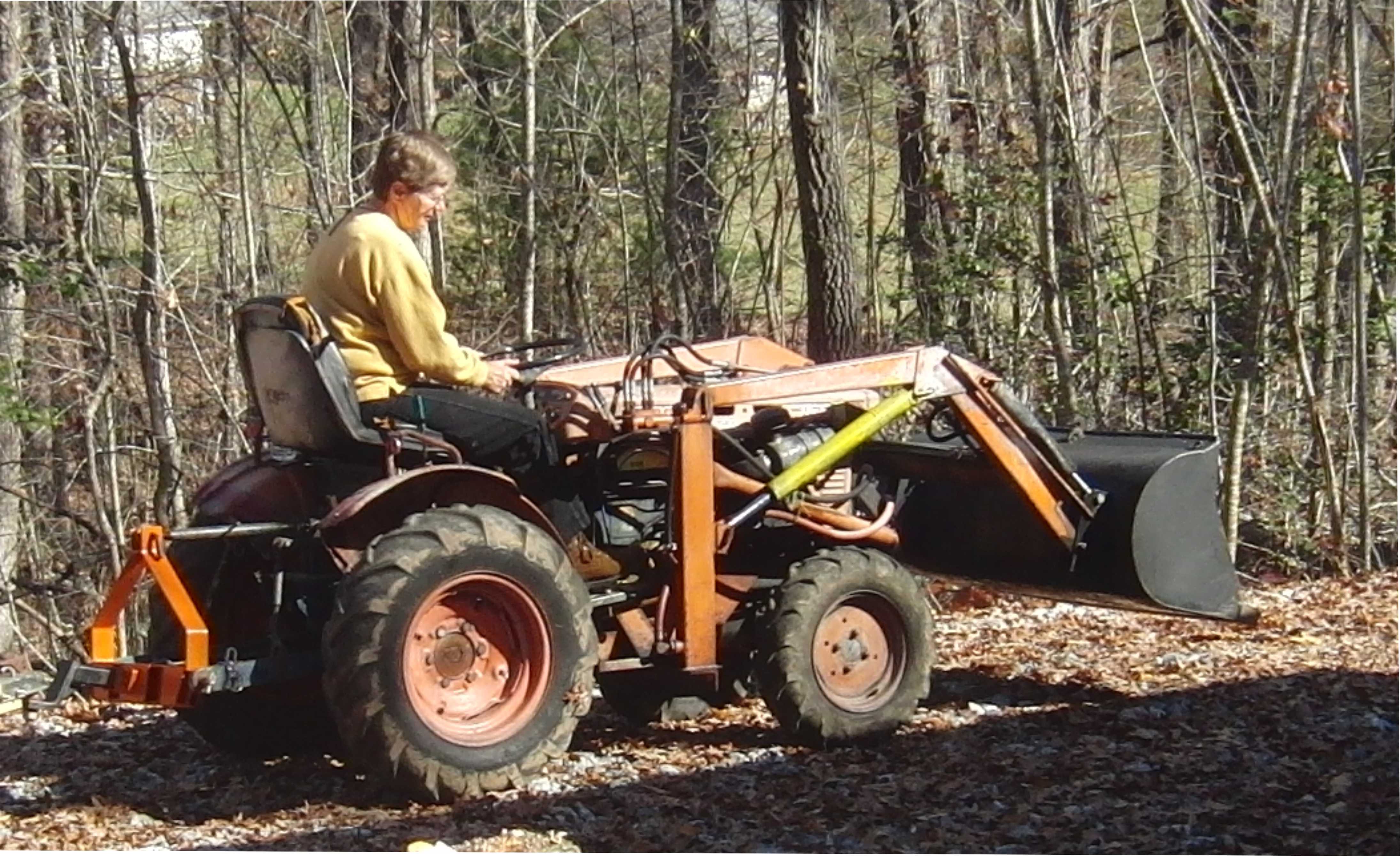

I am building a new attachment for my kubota B7100. what I need is the measurements for the loader arms and hydroulic rams at the loader bucket. I would measure mine but I am in florida and the tractor is in Georgia (650 miles) anyone have the ability to measure theirs for me??? THANKS in advance. Jaime

The B7100 was made for a lot of years. There are different loaders that could be installed on a B7100. You need to identify what make and model loader you have or any info you receive could be wrong for your loader.

i have a b7100 with the loader LA300B would you like to have the measures to make yourself one or is it too late?
   / b7100
definately not too late. I am not sure of the model of the loader. it is the one in the picture.

JPRambo,
With the image you provided you can measure this yourself to get it close. With the B7100 basic dimensions
Wheelbase: 49.5 inches [125 cm]
Length: 78.75 inches [200 cm]
Width: 40 inches [101 cm]
Height: 45.5 inches [115 cm]
Ground clearance: 11.375 inches [28 cm] (transmission case)
Clearance (front axle): 9.5 inches [24 cm
You can use measuring tools in Adobe to get the basic dimensions. I would not build from this but it gets you pretty close if you measure a "known" value then measure your picture. I have added your PDF with some red lines to and you can do the same with PDF.
Really depends on what you want to do?

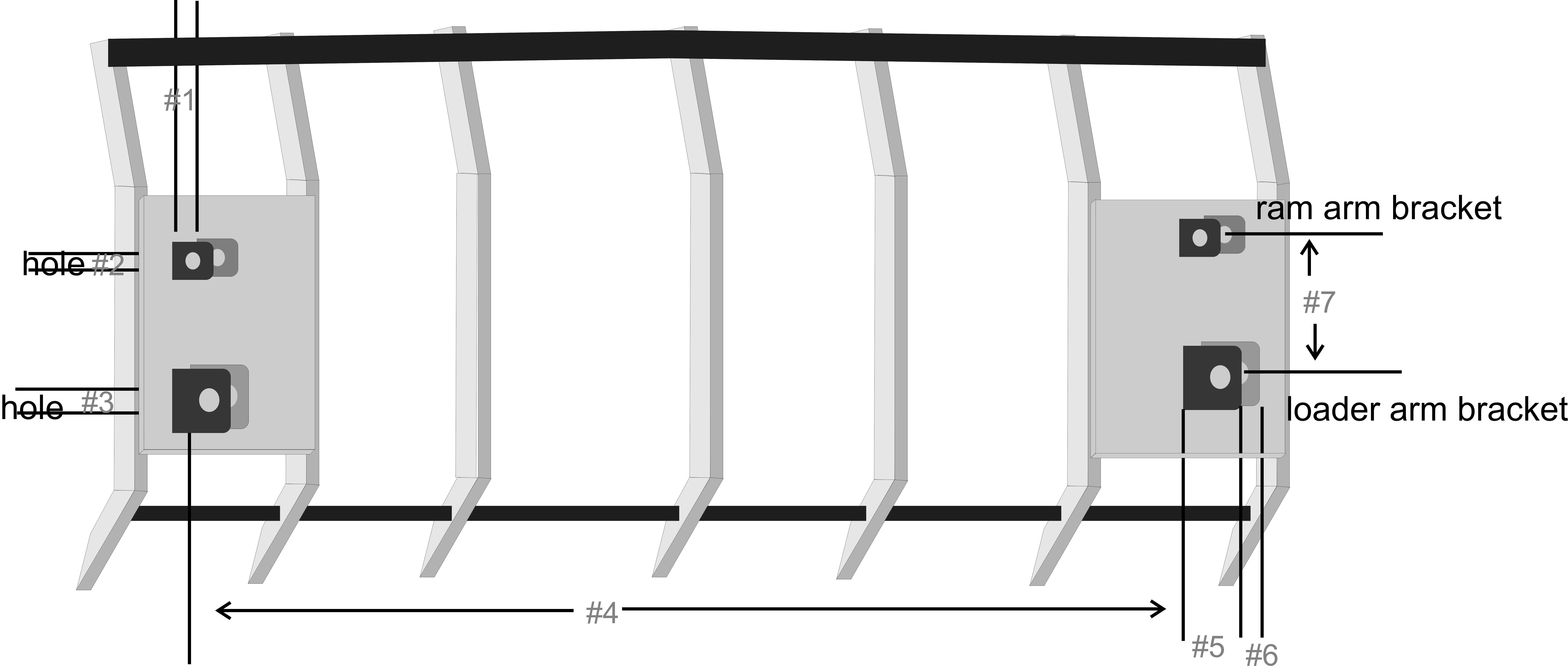

what i need is the measurments to put brackets on the root bucket i am making to attach it to the loader arms and the hydroulic rams and their spacing.
