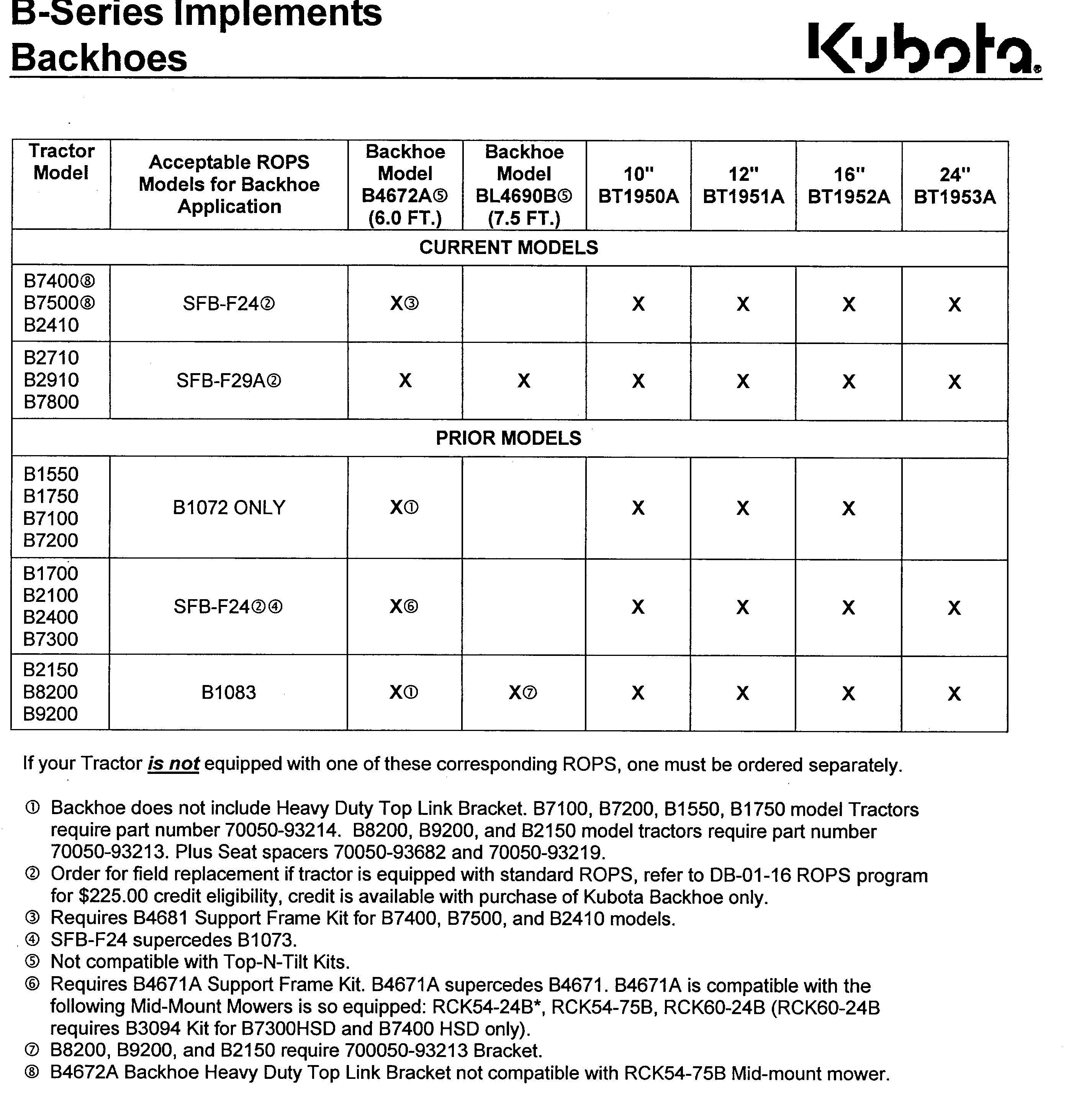

hi i have a 1986 kubota b7200 can i put a bckhoe on this is it big enough?
   / b7200 backhoe? #2
I have used my B7100 with a Woods BH750 for many years now. You will find many small Kubota tractors the same size as yours with backhoes.
   / b7200 backhoe? #3
If you want a k_ubota brand BH see the chart below:
