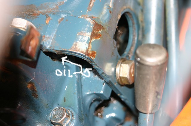

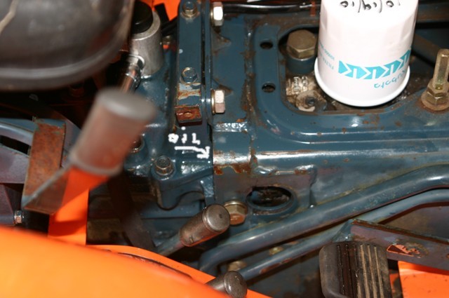

Here's a couple pics to show where this oil leak is. The white arrows point where the oil comes out. Still haven't determined if it begins leaking when the loader is used or the 3 point with the brush hawg being raised & lowered. Got me a small mirror to scope it with in the morning.
Any ideas are very welcomed... I hope I don't have to take the tractor in to the shop & I don't think I could separate the rear from the tranny myself but ya never know!

I figured out that it's the loader that is causing this leak. The 3 point doesn't make it leak when I raise & lower it. I also found that the leak appears at certain instances. I'm thinking it's when there is downward force put on the loader when it's on the ground. I raised it to the height that it would be while mowing and there was no leak I dunno. :confused:
When I was doing all this I noticed the leaks stopped after I had turned the hyd. valve off going to the front loader. After turning it on the leaking got less.
Anyone have thoughts or ideas regarding this weird thang?
.......b

It's leaking again! Thot I had it figured out. Still can't see where it's coming from and, to do so, I'd have to separate the rear from the tranny. Prolly will take it to the shop when money becomes abundant.
But I did get the steering tightened and figured out how to adjust the loader controls so they don't fade. It seems the plungers can be rotated or screwed in or out (tighten/loosen). I screwed both the bucket roll and the arms linkage pistons and the fade went away!
