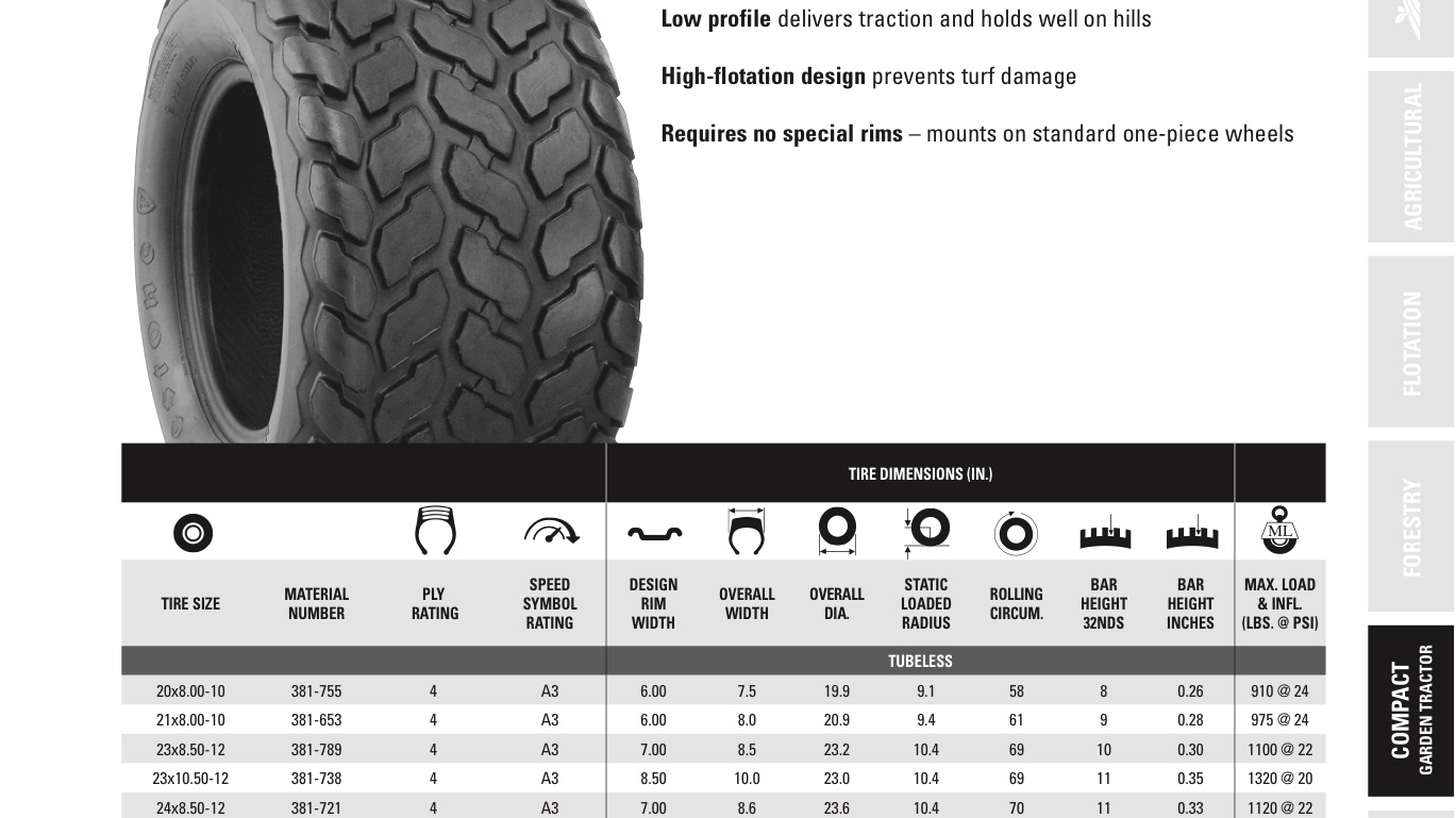

While not critical right now, my front tires are weather checked. They are Firestone 21x8.00-10 tires and no longer available from Firestone (discontinued). Looking at any in that size, I do not see anything available. Does anyone know of or if there is a replacement tire? Appreciate any help/ideas.

This is a replacement on a 4WD tractor...often used on wet soft turf...so size may make a difference. Owners manual does not give any 'optional' other tire size.
   / B7300 front tires #5
ATV's commonly use that size (21x8x10) and a 4 ply rating. Might be an option..
And yea I'd want to stay as close to 21" tall too. ..

Back to the tires... You can use a variety of sizes and treads. The spec. that you want to match is called "rolling circumference". All tires have this spec. and you usually can find it in the mfg's tech data. Or call them.
BTW, "rolling circumference" is measured, not calculated. It is not really related to diameter. It's a spec. all it's own, and has to do with the elasticity of the tire and how much it deforms from a circlular shape. I'll see if I can find some Firestone specs.

OK. Here's an old link to a Firestone catalogue shows that as a "turf and field" tire for compact & garden tractors.
http://www.yournexttire.com/content/Tirecatalog2017FirestoneAgb.pdf
It's what we call a "Turf tire" or R3. Flotation type mostly for mowing - although I like that tire on my own little tractor for general use.
Look at the rolling circumference or "RC" below. That's the number you need to match. Finding the perfect front tire can even involve buying new rims, but they are pretty reasonable for small front tire sizes. Rim specs are more or less universal across all makes and models....and the specs are stamped on the rim itself. I've successfully changed from turfs to ag type tires by changing rims and matching the RC.
