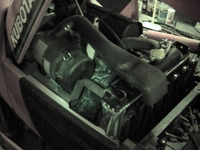

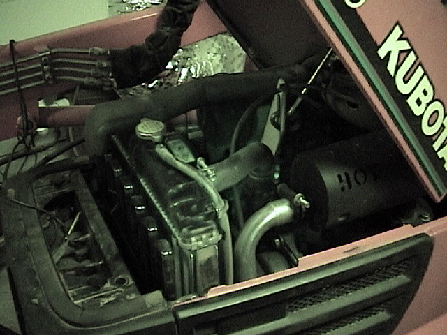

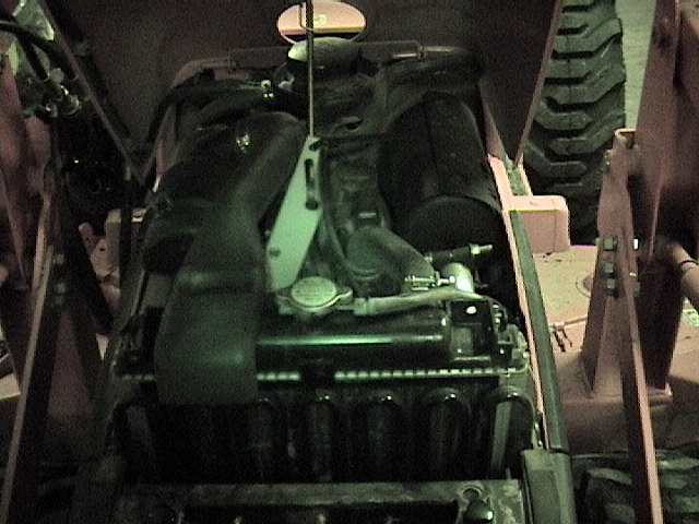

I need a pic of a B7500 on how the air filter and radiator mounts. Actually that bar that's next to the air filter that attaches to the radiator. I think mine's on bassackwards.
   / B7500 Pic #2
Here are three. Hope they help!
Jeff

   / B7500 Pic #3
another
   / B7500 Pic #4
and the last. If you need another angle....let me know.
Jeff

Perfect! I put the darn thing on upside down.... duh! Thank you.
   / B7500 Pic
Hmm, mine was like that. The radiator still needs to go 1/2 towards the front of the tractor.
   / B7500 Pic #7
I assume you mean 1/2" forward. Any chance you bent the bracket installing it incorrectly? Where is it interfering? I imagine changing the angles on the "Z" bend could easily take care of 1/2". It looks pretty flimsy.
