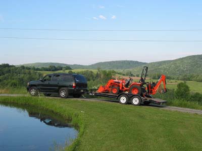

Not to confuse you but I think the trailer shouldn't be your determining point because I think the 12' trailer is too small for either model. You're too small on both the length and gross weight. (just my $.02) If it is rated at 2500# that includes the trailer weight plus the load (tractor). The second point and not insignificant, is that the 12' is too short for you to balance the load. I am pretty sure you will find you have way too much tounge weight when you load either of those machines.
That is not a position you want, very unsafe. Unless you are only going a few blocks and at that accidents are still an issue. Thirdly, does your trailer have brakes? You'll need them too with that puppy behind you.
I have a B7500 with a FEL and a BH and I use every bit of my 16' trailer. I am going to post a picture of mine loaded and at the balance point for my machine as outfitted. Keep in mind your trailer is 4' shorter, I do have the BH on though. I trail mine 110 miles between houses and the 16'er is comfortable to tow.
I guess what I'm saying is buy the tractor you think is best and think of the trailer as secondary. There are a bunch of folks here who are more expert than I am with the trailer size, I'm sure some of them will be helping you out with an opinion also.
