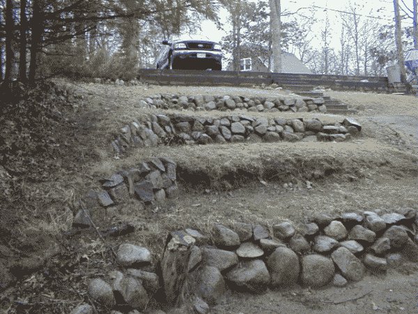

Hello everybody ,thanks for the replies well here i go this is the hill that i will be removeing it is apox 30' deep by 44' wide 8' high apox 200 yards of sand and gravel i will have all summer to move it to backyard and build retaining walls .Question is do you think that this project can be done with the b7500 or am i asking to much of this machine ? Pictures to follow
Michael!!!!

   / b7500
#9
Sorry lets try again

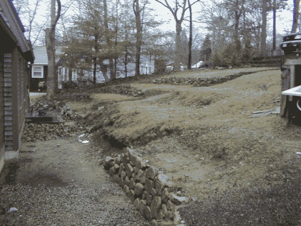

   / b7500
This is side view
