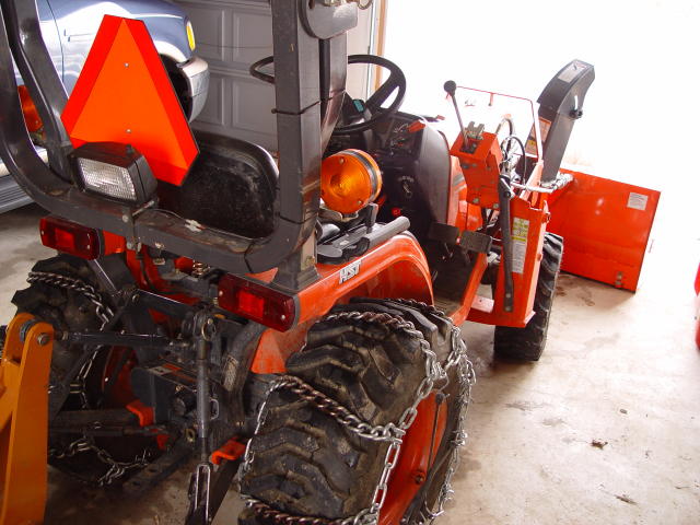

Yup...they're a good little workhorse.
I run mine at 2500 rpm for the snowblower, MMM, and tiller.
That gives it enough power. If I don't, I have problems - either the snowblower will clog up, or the mower will leave a lousy cut.
I'll throttle back and forth alot when using the loader though.
The hst will rob power from one post if you have two implements going. I never really do. I do have a back blade on when I run the snowblower; I have to re-lift it every now and then because it slowly creeps down. When I do that, I can hear it take power from the blower.
