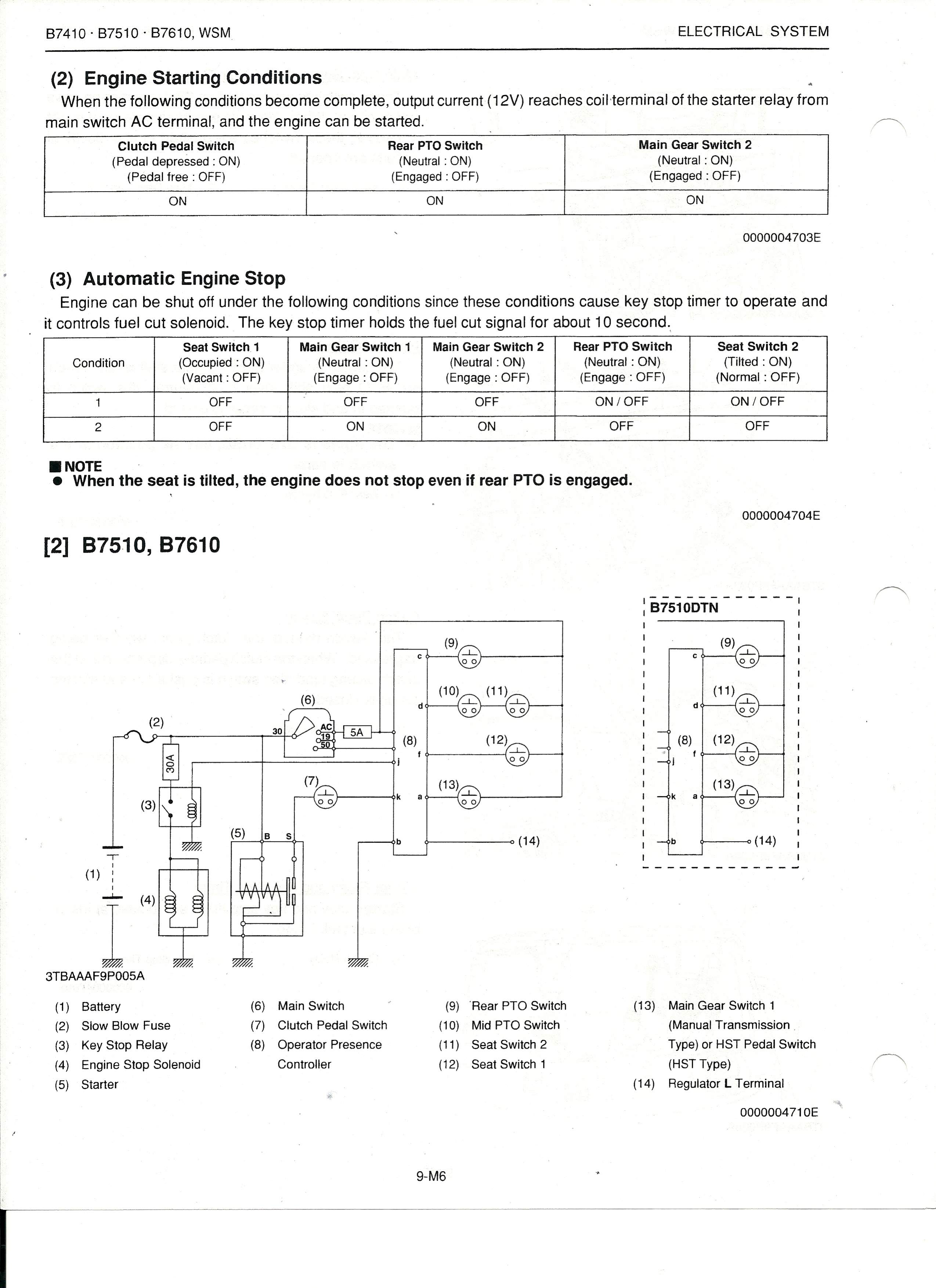

This page is out of the service manual. Is it #3 or #4 that could be bad?
   / B7610 No Start #6
I'd suspect 3 first. It is under the dash where you are banging and relays are always suspect because their contacts wear and can get stuck. If you get in there, unplug and plug back in all connections in the circuit. Since it is intermittent and responds to your banging, it may be just a poor connection from a little corrosion. The connection from 8 to 3 brings up another possibility of failure mode. 8 generally must be working or it wouldn't allow you to crank but that one connection might be bad. You would need to get a meter on it to see.

After figuring out how to remove the instrument panel, I noticed a lot of dirt and some grass clipping behind it. I cleaned everything up and discovered that the terminals on the Key Stop Relay was dirty and now it starts. I ordered a new relay for a spare just in case. Thanks the8080 for your help narrowing it down.
