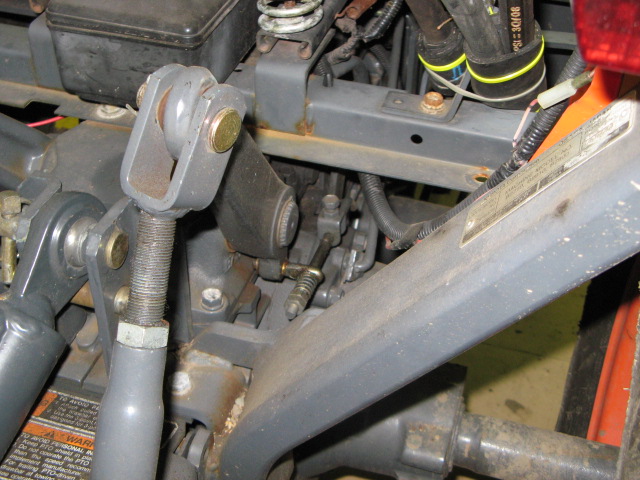

Wanted to ask what I can look for in solving the problem of my mid mount mower raising and lowering slowly on my B7800. The quarter inching settings are not working at all. I usually have to move the controller up and down several times to get the mower to raise or lower. Thanks in advance!

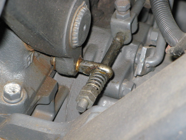

I had that same problem with mine when I bought it and it turned out to be the connection between the valve and the linkage, I believe the technical term is the feedback linkage.
there is a rod that slides through a bolt with a hole in it and there is also a spring on the rod. mine was rusted up and the rod was no longer sliding so what happened was when I lifted the handle this feedback linkage that was seized was telling the machine that the 3ph was at the top of its stroke even when it was at the bottom.
this feedback linkage is located under the seat on the right side of the tractor. have someone move the lever while you watch and you should be able to see what i'm talking about. I believe there is a snap ring to hold the linkage together. I took it all apart and use sandpaper to clean it up and greased it well before putting it back together and it has been working fine since.
hope that helps. I will try to get a picture up so you can find it easier tonight

sorry it took so long but here are some pics hope that is the problem because it is an easy fix
there is a snap ring on the inside of the 3pt lift arm. the problem with mine was not that it would not slide on the rod, the real problem was that the fitting was not rotating in the 3pt lift arm so it was binding on the rod.
I don't think I had to touch the bolts and spring I just pulled the snap ring and pulled the fitting off the arm with pliers and greased the part that goes inside the 3pt lift arm
if you do have to touch the bolts make sure it is properly adjusted, this feedback linkage controls how far the 3pt lifts and is adjusted so that there is still some freeplay in the arms after they reach the top. If there is no more freeplay the cylinder is bottomed out and it may damage it.
hope that helps and again sorry for it being so long but better late than never
