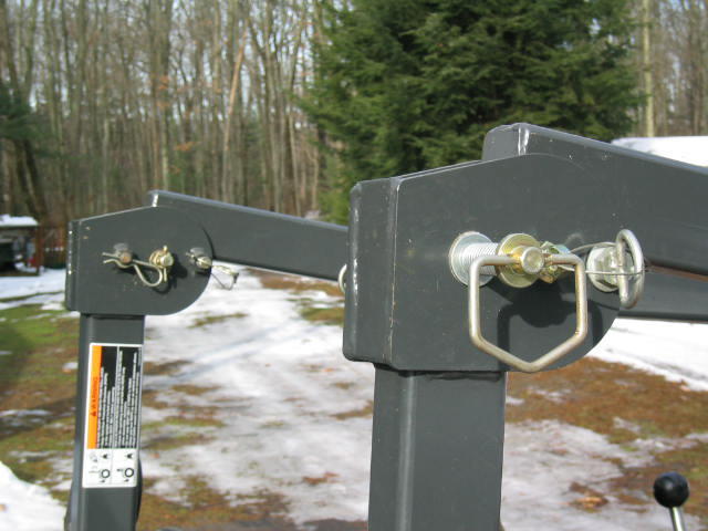

I wrestled with the same inconvenience /forums/images/graemlins/mad.gifand simplified the process by drilling out the nut with a 5/8" drill bit and substituted a 5/8" pin,flat washer,compression spring and retaining clip /forums/images/graemlins/smile.gif , now it's only half of the pain /forums/images/graemlins/smile.gif ..RayBee

RayBee, I have the same style folding ROPS on my B7500 and have thought about using a pin, but got to wondering... Did Kubota use a bolt because they need the strength of a threaded fastener to keep the hinge from spreading open in a bad rollover? Or is it just for redundancy in case someone leaves out the existing safety pin? I sure would like to know before I start drilling, which I probably wouldn't do until my tractor is out of warranty.

Offically speaking, the modification would fail a osha test! That is a illegal modification, same as drilling rollbars to mount lites. At least I've seen that written up with explanation.
   / B7800 ROPS Question #8
Art: .....I agree with you, /forums/images/graemlins/blush.gif and there are those who would not tamper with matress tags, for fear of being turned in to the bedding police /forums/images/graemlins/laugh.gif
I only offer my modification as my solution to the annoyance and certainly each owner should deal with it in a manner that is consistent with their opinion on safety issues. /forums/images/graemlins/shocked.gif Best regards, ...RayBee
