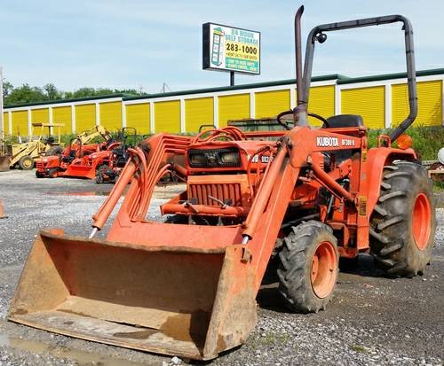

Here is the tractor... just for looks... the more I look at it, it looks really, really used and somewhat abused.
   / B8200 HST - Should I stay or should I go? #9
That tractor is at a dealer and they aren't fixing it????? That right there is very BIG reason to pass, they know what it cost. The cost to fix is more then they can sell it for.
   / B8200 HST - Should I stay or should I go? #10
Doesn't look all that bad to me for the money. Over here you'd probably pay a lot more for a lot less.
Its not really unusual that a dealer could not afford the time and effort to fix a tractor like this and sell it at a profit. But that doesn't mean that a home mechanic couldn't come out ahead.
