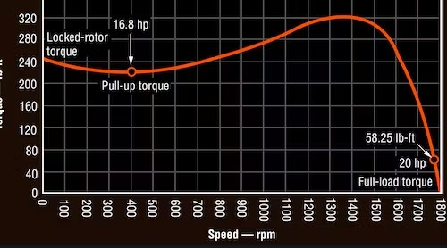

Here's an example torque curve for one of those hydraulic motors. The graph reads torque on the y-axis and rotational speed on the x-axis. You can see that at high RPM the torque drops very low and that there is an optimum torque output somewhere around 2/3-3/4 of the max speed give or take. So this is why backing off a bit when you need more torque makes sense

So from a less theoretical and more practical standpoint, it is possible to have one pump go bad without the other; as it is possible to have a linkage problem. The linkages can be lever or cable type but they are complicated mechanical assemblies. I would start by taking off whatever covers you need to to visualize that linkage assembly and with the tractor off manually actuate your treadle or pedals and look closely at that assembly.
If that assembly is functioning like it's supposed to, then start checking pressures with an oem manual as suggested above
