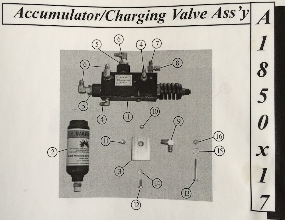

Hmm. What valve are you guys replacing...the accumulator or, literally, some type of valve? Any pictures? I have a problem with my 1845 where it will "hesitate" when changing direction. If you press the tram a little more, it will lunge forward/backward. I'm not talking a "huge lunge." But enough to be very annoying...especially when trying to ease up on something.
   / Back amongst the living - update on all the issues #6
This is the hydraulic accumulator that keeps the brakes on until the the hydraulic system pressure clears about 600psi. Conversely, when the pressure drops, the brakes come on automatically. It is a small block of steel with a pressure regulator/relief in it, and connections to the brake circuit, the aux circuit, a small hydraulic accumulator to take out the surges, and the tank, plus some of us have the vent connected back to the tank, because each pressure cycle releases some oil.

Peter, you are on your third as well????? That was a brand new machine wasn't it?
   / Back amongst the living - update on all the issues #9
Hi Marrt,
I think I've attached a picture of the charging valve. As Peter says, it sits in a whole bunch of circuits. I've never experienced what you're describing. Mostly when mine fails it has blown seals and just leaks oil all over the place, without changing the behavior of the 1850. It's interesting how many of these things we're all replacing. Peter, do you remember the source for the generic? If it's a drop in replacement, I'm keen to try one.
   / Back amongst the living - update on all the issues #10
Yes, my machine was new (645 hours at the moment). Yes, it is my third. As Mike says, usually when it goes, it is a blown seal and oil goes everywhere. Terry and I had a chat about whether my flipping the brakes on/off routinely had an effect (Terry thought not), but other than dirt getting on the outside and transferred inward on the piston, I don't know why they failed so quickly.
I don't remember the source. I do remember that it took me some abracadabra-ing to find the right words to describe the valve. Needless to say, it isn't made by PT... Looking quickly, I think it was a Hydac "accumulator chagrinning valve", DLHSR, Minco, and others make valves that do the same thing, but the item above looks like a drop in replacement. I'm not next to the tractor, but my memory was that one had to count up the ports to get the right version.
Let me know what you think. As I mentioned before, I think that it might (will!) require some "tuning" to set the pressure on the regulator high enough to relieve the brakes.
