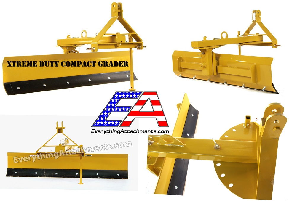

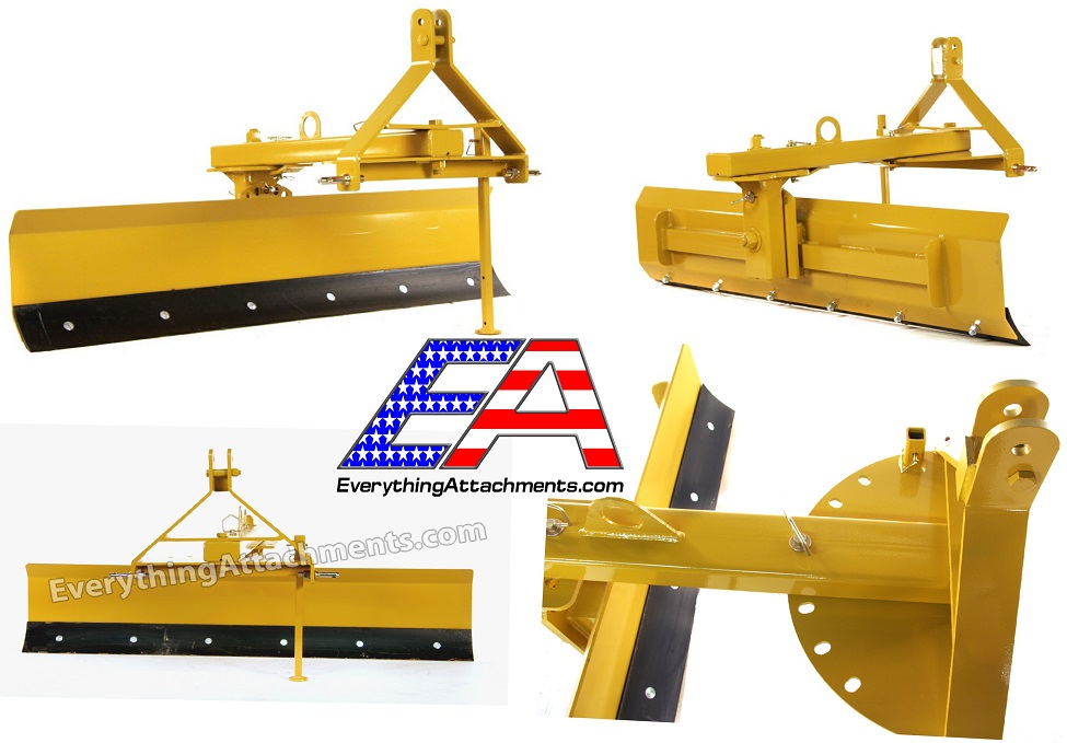

I say 60" with the majority. The EA 6 way deluxe blade is an excellent value with easy tilt, angle and offset adjustments!
Travis
   / Back Blade size for a Boomer 24 #9

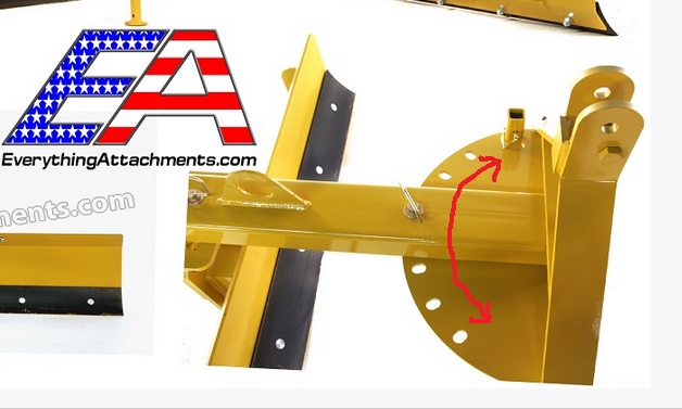

The offset feature of the EA blade makes it even more adaptable Because you can swing the blade even further to the left or right (especially good for snow)
