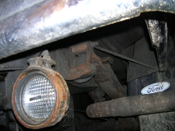

I added the halogen par 36 rubber mounted tractor lights to the receiver hitch and protected them with a piece of 4" steel pipe, put them on my 94 F350 in 94 ,been plowing ever since and haven't broken them off yet. I wired them through a relay and a single pole double throw switch : up is on, nice for work lights,hooking trailer etc. center off, no use running them in the day and down is 'auto' tied to the truck backup lights to come on whenever in reverse- a thing of beauty !

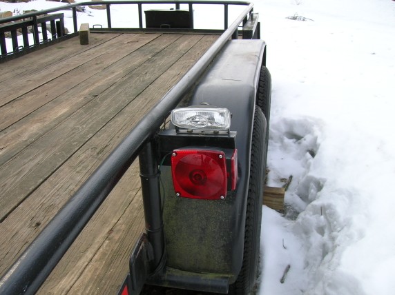

Heres my backup lights.There on a manual illuminated switch thru a relay.

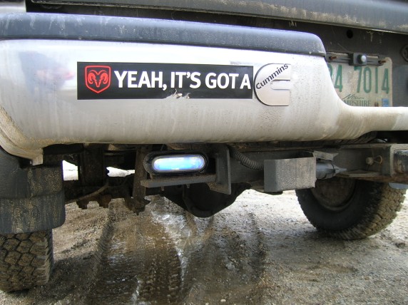

Those lights in the back bumper of that Dodge look nice. I have all the lower rear lights on my horribly ugly 1966 International 1300 4x4 "offroad" truck protected by, and shining through holes in, a a 6" channel iron bumper. My installation isn't so nice looking, but we both have the same idea. We do tend to bump those rear lights when working our trucks in the field.

Here are my lights :Trailer, F350 sorry I didn't pull out of the garage $4.079 / gal today ! and Ram 2500.
