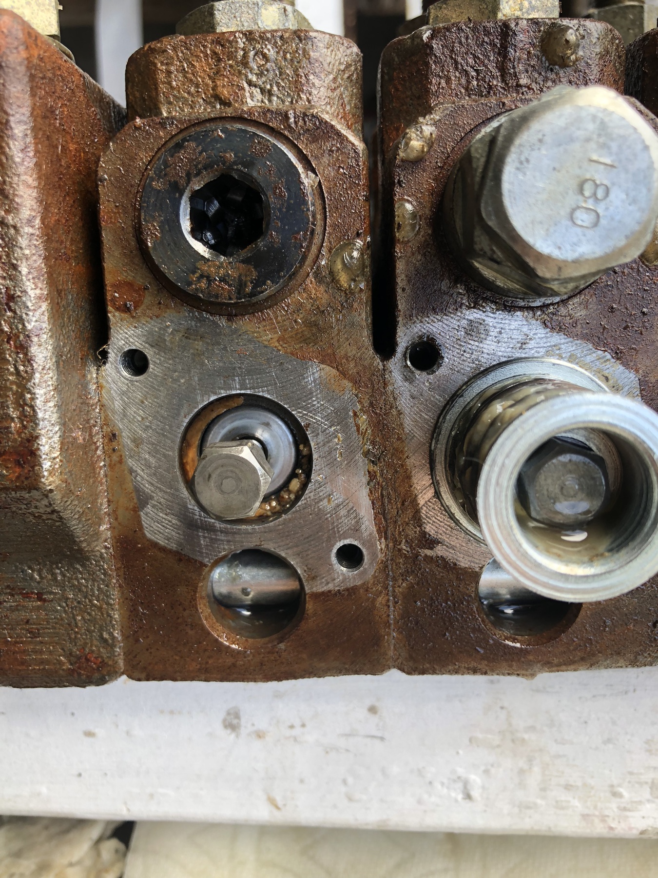

Thanks Victor
Would add additional caution. Be mindful reinstalling the centering spring. I found out after control valve was reinstalled, plumbed and running. Dipper stick immediately went to full extension. ☹️ Somehow managed to reverse the 2 parts at arrows.
Had to totally uninstall and correct. Fortunately it was the only one.
Once hooked back up, I put it thru all its motions then left running under pressure about 45 minutes and no leaks.
Tomorrow I hope to use to close in my gas line trench.

Happy ending when you spend $20 in parts instead of replacing the unit for $1000. And now you have a cheap lifetime supply of spare o-rings. I still don’t understand why they used the white crap o- rings to begin with. All that matters is that you fixed it and now you can do your “ I fixed it” dance. Job well done.
