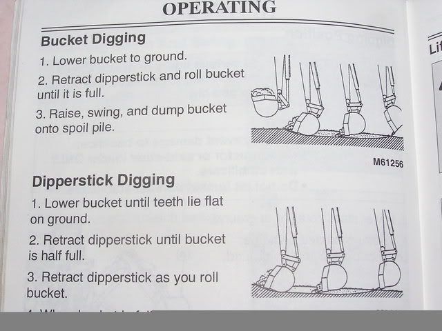

There are two types of digging techniques with a hoe.
1) Bucket: that is digging by curling the bucket towards the machine and filling the bucket.
2) Stick: that is digging by pulling the stick in towards the machine and filling the bucket.
Hope you understand my description of the difference.
Digging force-crowd: is the digging force at the bucket that is generated by stick digging.
