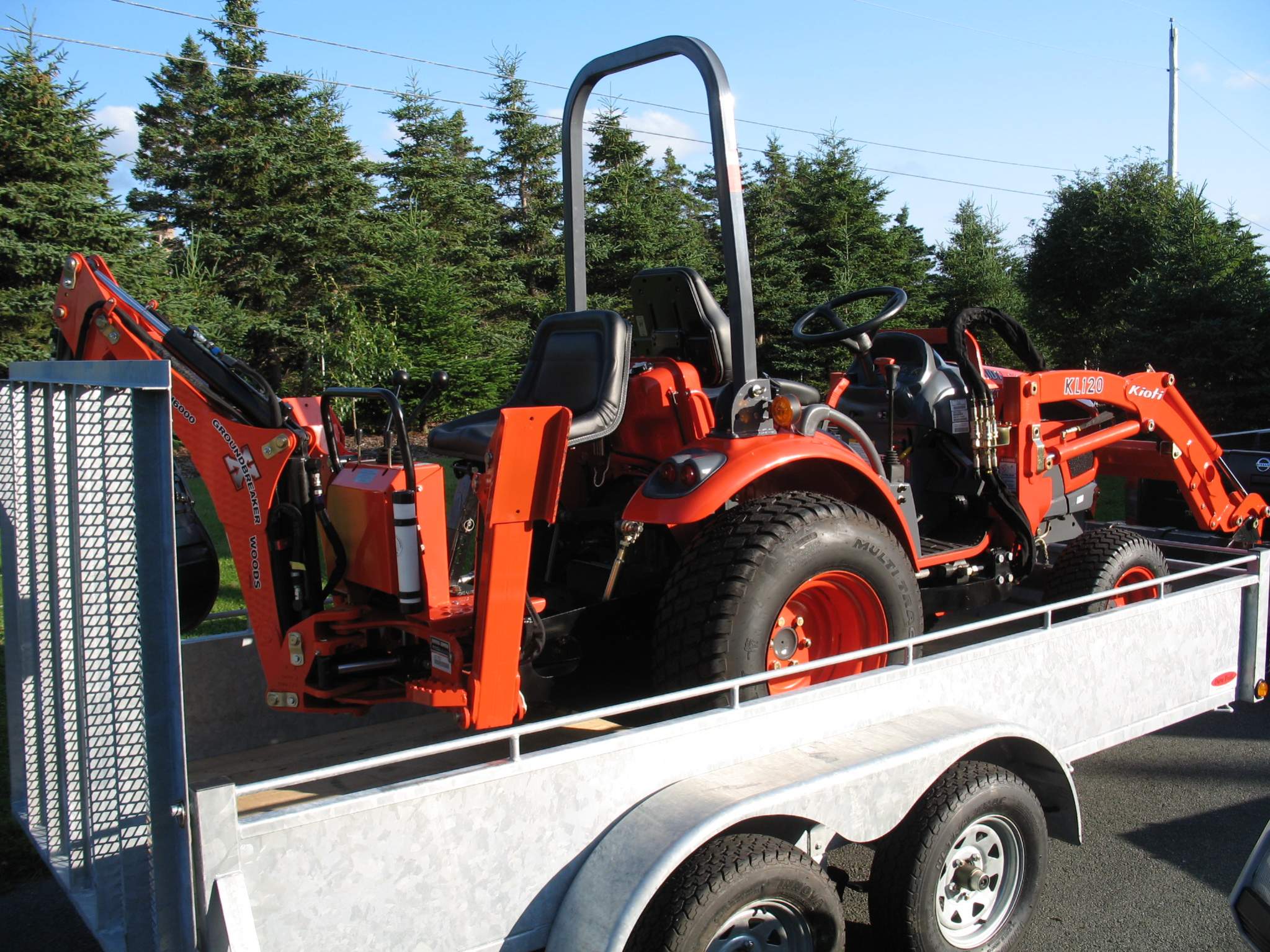

I have the Woods sub frame mounted BH6000; Reg has the newer model Kioti. Although the Kioti has less clearance, apparently he hasn't had an issue with it.
Looking at both side by side, I would have preferred the Kioti as it seems to be a little more substantial than my Woods. However, I haven't found a stump I couldn't take out with it, and I took out 40-50 averaging 10"-12" so far.
