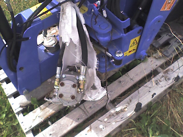

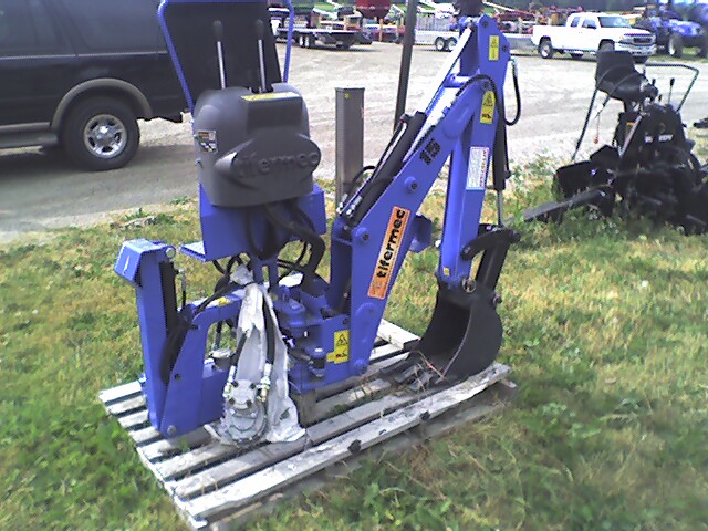

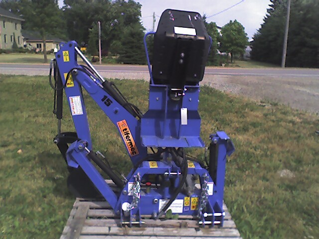

I have been without my tractor for the last 3 days, suffering a bit of withdrawal ;-) . My local NH dealer (McGavin Farm Supply) took it over to the Tifermec people so they could measure it up for a sub-frame and give me an idea what I am up against.
Well I heard from them today and it sounds great thus far. It will be a two piece sub-frame, the front half remains on the tractor and will only reduce my clearance by 2 inches at the most. It will not interfere with the mid pto or if I were to ever decide to mount a mmm . The back half remains attached to the backhoe and they said I should be able to raise the 3pth all the way, just back into it, hook-up a couple of pins and away I go. :)
I am attaching some pics of the backhoe itself that I am hoping to get. These units are very strong, with a digging force of 4,450 lbs, so it should have no problems with the jobs I have planned for it.
