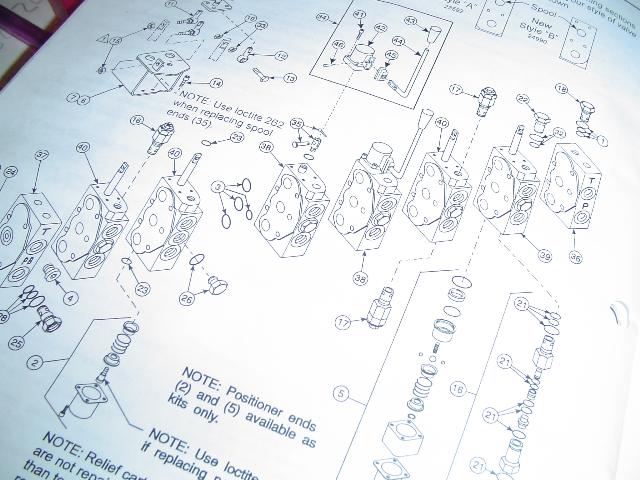

After looking forever to find the manual, I see what you are talking about. However, the outrigger controls also cause this sound and I don't see relief valves for them. That would make it the main relief valve. Right? Any way, I included a pic of what's in the manual so you can see what I'm looking at. It shows 16 17 are work port reliefs. 18 is the main relief.

Yikes your control valve is exactly the same as the one on my New Holland. I'm now wondering how many different manufacturers use this same group of valve bodies? Anyway the main backhoe relief is number 18 as you said and it is set at 2000 PSI.
When you move your stabilizers without reaching the end of the travel on the stabilizer cylinders do you still hear the noise?
