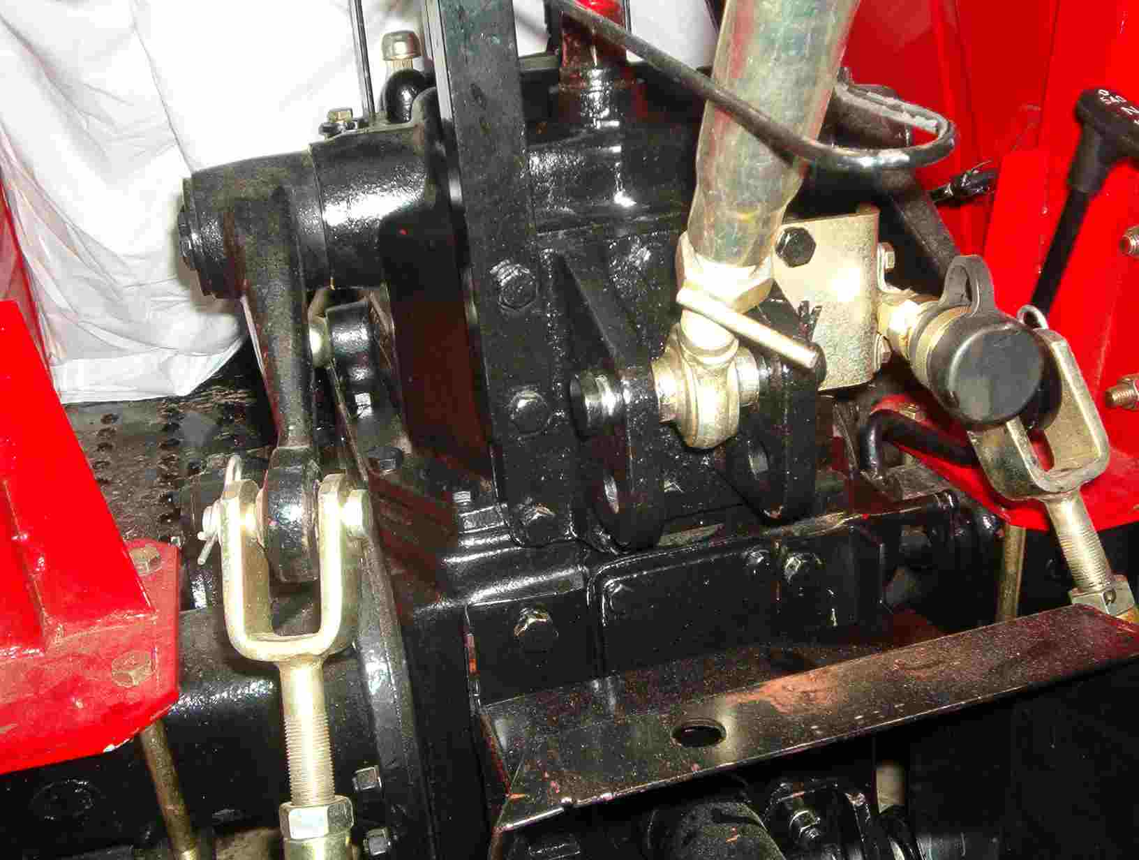

Hi RonMar, I have a new 284 LE (July 2005) and it does not have a return connection at the rear. My LW-6 backhoe I think is supposed to run off the tractor. It came without the quick fit connection and I am very uncertain on how to resolve this issue. I have sent emails to our friends in China but no luck so far. Any ideas or can you show me with a drawing where I should install a return line on my JM 284? Thanks for your help.

Did yours come with a small pump that could mount to the rear of the tractor. Also, do you have an external resevoir tank with the attachment?

Hi, no pump was included. Here are some pictures of the BH and the back of the 284 LE. Only a female quick connect on the back of the tractor and the two hoses from the BH, one comes from the valve control setup and one from the auxilary tank. Do you know where I could by a hydraulic pump that I could set up on my PTO? Thanks for your help.

   / Backhoe Hydraulics Jinma 284 #6
Here is the picture of the rear of the 284 LE as you can see only one connection.
   / Backhoe Hydraulics Jinma 284 #7
If you have the auxillary tank, you need the external pump for easiest install. Tommy or Chip probably has one. If not PM me and I will get one for you.

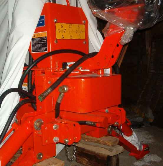

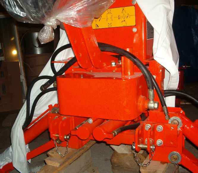

   / Backhoe Hydraulics Jinma 284 #8
Hi Bruce, Yes it has its own hydraulic tank. See enclosed picture. Who is Tommy or Chip?? I am really a newbie at this. What would be required to do this installation. Would the chinese made hoses and connections work with this pump. Is there a mounting block that comes with it? Does it bolt to the back of the tractor directly on the PTO shaft? How much and what is the delivery delay? I am in Canada in the province of Quebec. Let me know if you can. Thanks again for your help.

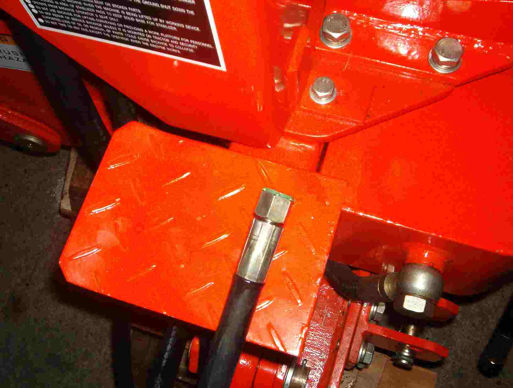

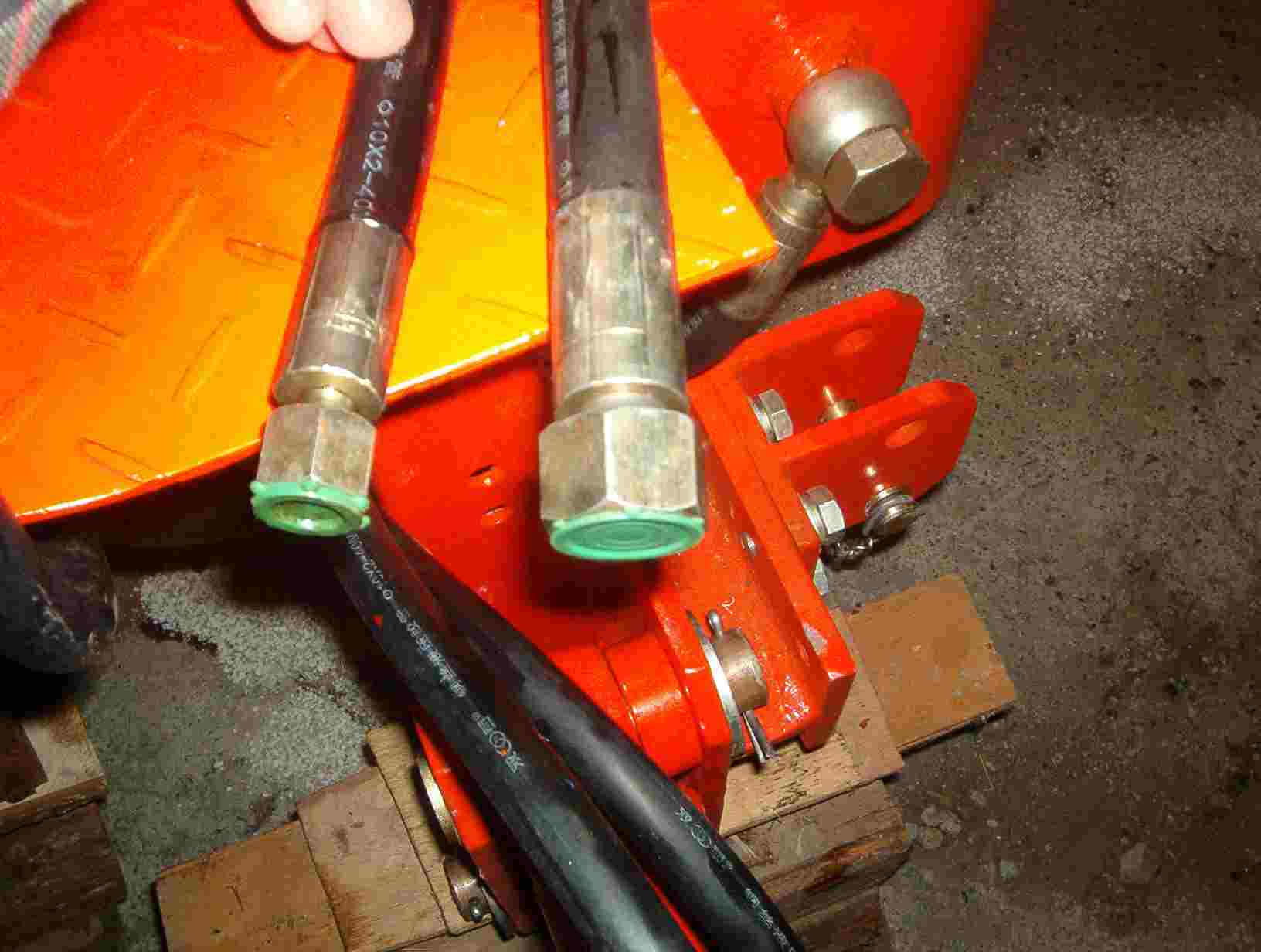

   / Backhoe Hydraulics Jinma 284 #9
Bruce, went out and took better pictures of the tank and the back of the backhoe. Here you go. Thanks for your help.

   / Backhoe Hydraulics Jinma 284 #10
This is a picture of the backhoe from China for a Jinma 284 LE, as you can see it does have the auxilary hydraulic tank and also the connectors are standard and not quick connect as they are on the tractor, oooops, only one quick connector on the tractor.
