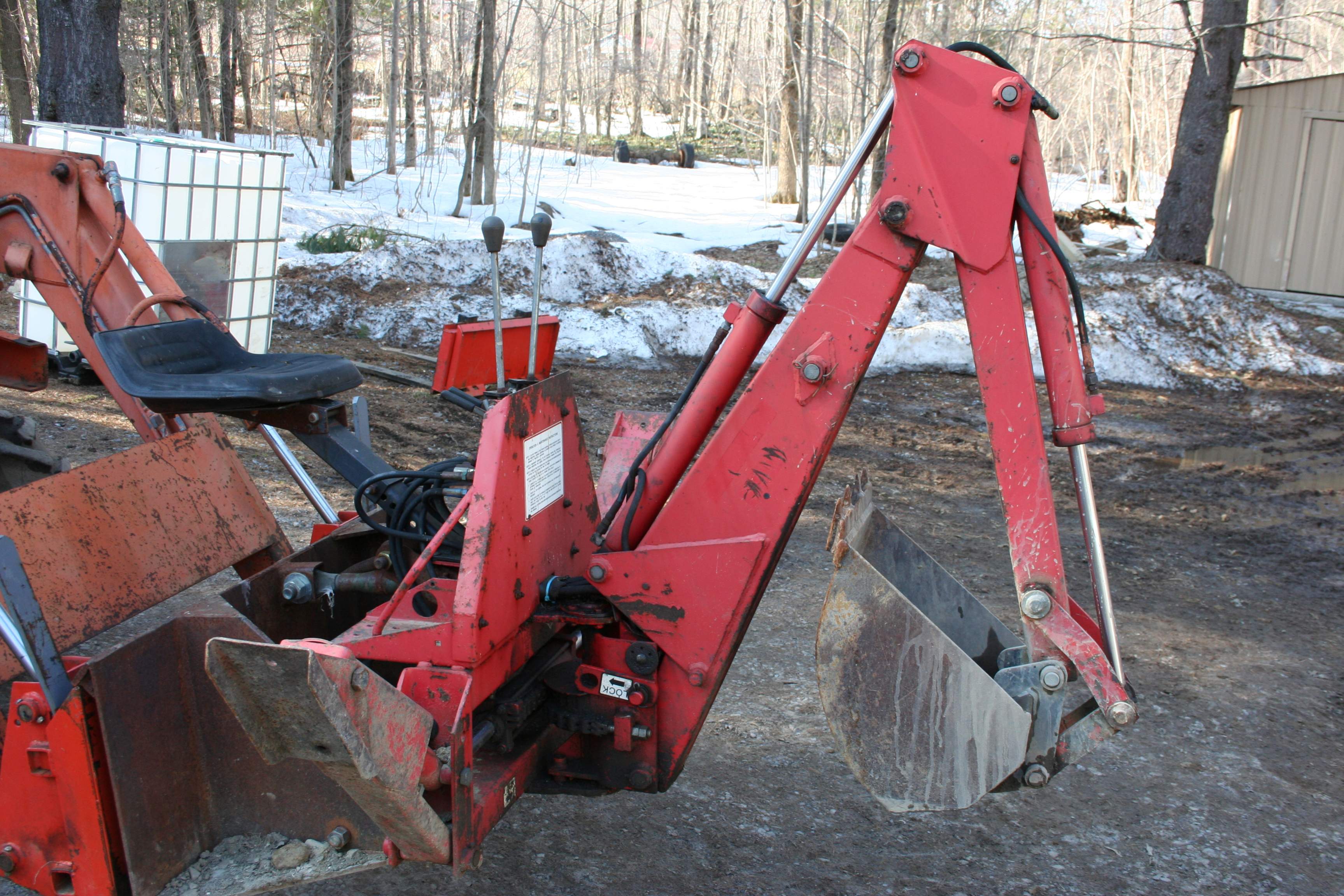

This little guy came home with me today. I cannot find a ID plate anywhere on it and the stickers have been removed for whatever reason:confused:.
Anyone care to guess the manufacturer or model? It looks like a Woods to me but I have not found an exact match on style.

I had an 18hp Yanmar tractor about 20+ years ago and that hoe looks identical to the one I had on it. It actually had Yanmar stickers on it but I believe it was a woods or whatever John Deere used on their 650 tractors since the Yanmar was basically the same machine. The hoe held up well to lots of jobs it never shoulda attempted, hope this helps but I'm not sure I really gave you any solid info.

Well after looking a a million pictures, I think its a Woods 650.
   / Backhoe Identification Help #4
Woods bh650 or bh750. I had the same issue identifying my Bolens BH and I think I scurried up some evidence that Woods made them for lots of companies that just slapped their own logo on it. Like Tags said, mine was covered in Bolens data plates, but it is clearly a Woods unit.
Go to Messicks.com and they have full exploded parts diagrams for you and operation manuals online for free. I found one somewhere. Just search Woods BH650 or BH750
That's a pretty sweet way to mount it! I have mine on the 3ph and you can't get the weight needed to dig. The hitch has no down pressure and it's hard on the arms. The way you have it looks like you could actually get the weight of the tractor to help you out without too much stress. How is it driven, PTO pump or off the tractors pump?
