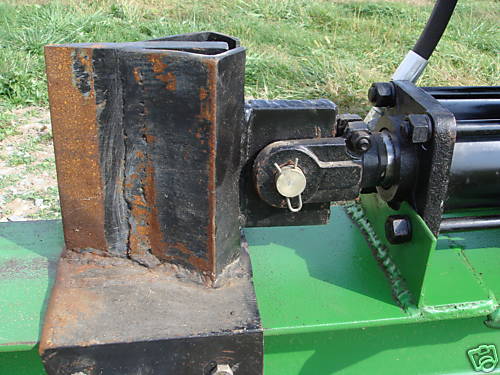

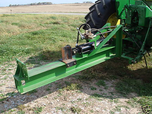

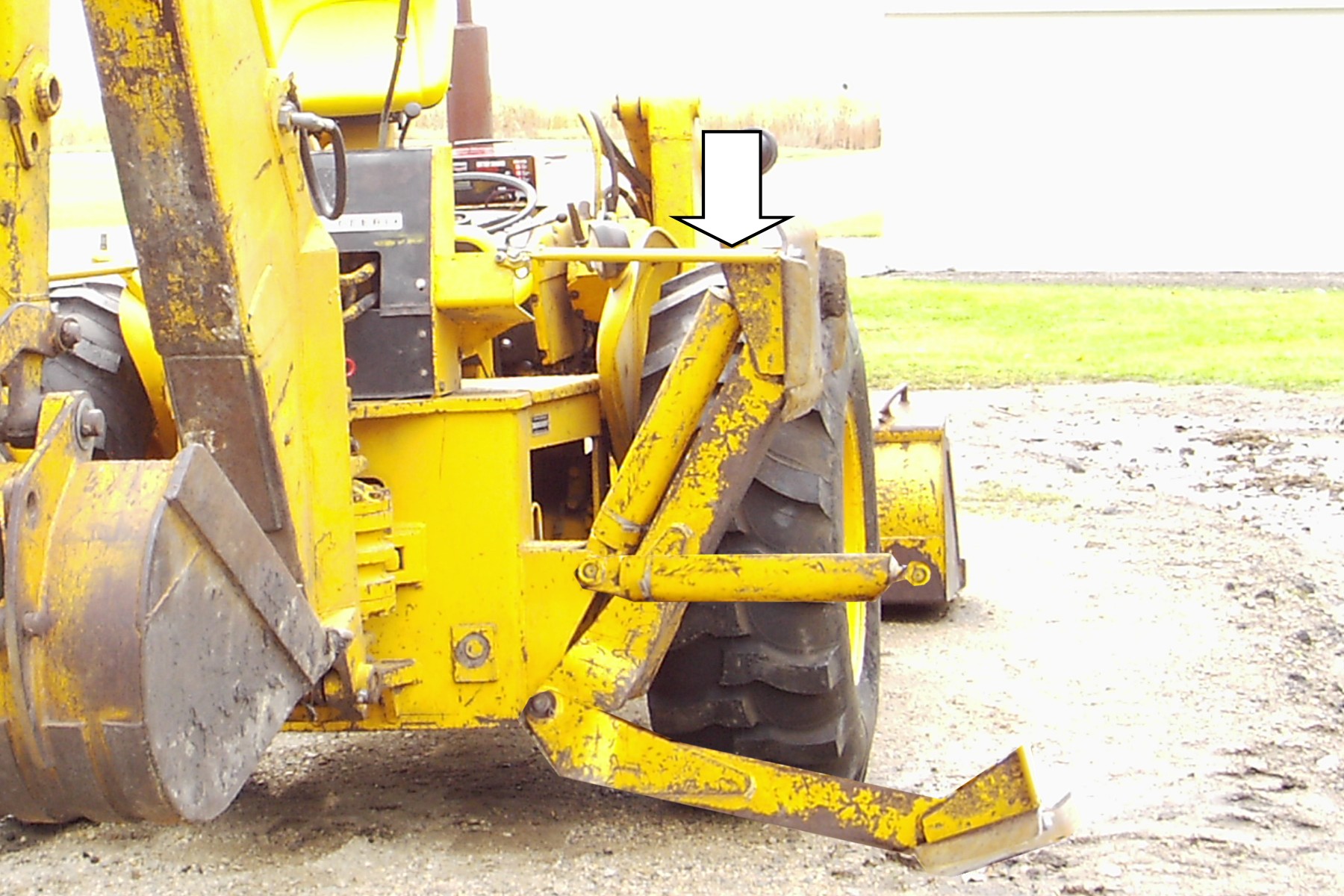

could use some input on a project I've had bouncin' around in my head. I could use a log splitter as I plan to start heating with wood next winter. I own a late '60's john deere industrial backhoe. so I thought to save $ I could utilize the hydraulics to fab up a splitter using one of the stabilizer cylinders (4" X 20 or so inch stroke). my thinking is to just lower the stabilizer, disconnect the outward pin-to-foot pin, lift up that end of the cylinder and attach it to my fabricated bed, attached somehow to the bachoe. i would need a support for the outward end of the bed, of course. I thought of attaching the splitter wedge to the cylinder rod and a solid flat end to the far end of the bed so I don't have to go chasing after the split pieces. I'll try to attach some pics from a 3pt splitter on Ebay that looks like what I'm trying to do and also a pic of the back of my hoe. anybody ever tried this approach? thanx for any help in advance

Seems like a lot of monkeying around.
Why not just build one like in picture 1?
Also, the cylinder should be at least 4". Any smaller and the wood will win.

hey, fellas. thanx for the input. jb, I'm retired, so I have plenty of time to monkey around. and cost is a concern. i love to recycle and use what ever is available. it just makes sense to me to use the hydraulics on the backhoe and by using the stabilizer, the control handle is within easy reach. the 4 inch cylinder is a concern, but the largest wood i would be splitting is maybe a 12 inch chunk of elm. do you think it can handle it? i don't know, as i've never split wood before. that youtube video is interesting, but it would be tough to get the wood split into the size pieces you'd want, i would think. if i go with the 3pt type as in the pictures, i would have to get an I-beam about 6 feet long. anyone know what size to look for? 6 or 8 inches wide? 8, 10 inches high? or is there an alternative to the I-beam? so many questions.....

crashz... safety is a big concern for me also but in this case it's not a problem. the backhoe has 2 safety pins. a 1 inch pin is dropped into a hole running thru the swivel plate on the boom and another hole in the tractor mount itself, eliminating the chance of boom swing. another pin does the same for the boom so it can't drop. both are, I believe, to prevent any accident , should a hose break or cylinder fail during transport. the handle controlling the stabilizer is the short one closest to the cylinder, so it's within easy reach from the ground. maybe you can see it in the third pic i posted.

Talking about safety .... I hope I dont offend anyone, but there seem to be a few issues with the splitter in those pics. The welding on the flare plate on the wedge does not seem to have penetrated very well, and IMO the angle iron on the cylinder is too thin with no gussets. In fact, in the one pic it even looks like it is bending, which will start to put an uneven load on the bolts. I would be worried about a failure right there.
